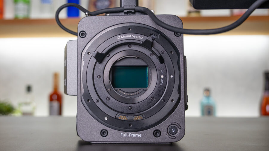

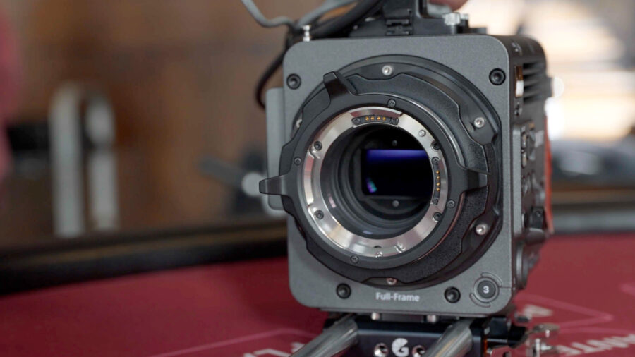

Below the camera’s PL mount is Sony’s native E-Mount, similar to the setup on the VENICE 2. This enables the use of a wide variety of lenses with the BURANO, including native E-Mount lenses and EF lenses, and so on. The main difference to the VENICE 2 in this case is that the BURANO also supports autofocus on E-Mount (more on that further down below).
8.6K full-frame sensor, dual native ISO​
Like the higher-resolution version of the VENICE 2, the Sony BURANO has an 8.6K sensor with a dual native ISO of 800 and 3200. It’s likely the same sensor and it uses the same color science, and Sony says it shares “most” of the VENICE 2 specifications including a claimed 16 stops of latitude. Our CineD Lab Test of the VENICE 2 resulted in 14.2 stops at SNR=1 and 13.2 stops at SNR=2, which are among some of the best results we ever obtained in our tests, surpassed only by the ALEXA Mini LF and ALEXA 35 cameras. We will test the Sony BURANO in the Lab as well but expect similar results.
Sony BURANO sensor, and the E-Mount below the PL mount (which is not attached here).
The Sony BURANO shoots 8K at up to 30 frames per second in full frame, 6K at up to 60 frames per second in full frame, and an S35 cropped 4K at up to 120 frames per second. There are some binning modes available that allow for lower-res recording at full frame readout but it was not immediately clear what modes those are. We will cover this in our full review of the camera. (We expect to receive the camera for review in the fall.)
Here’s the PL mount attached to the Sony BURANO.

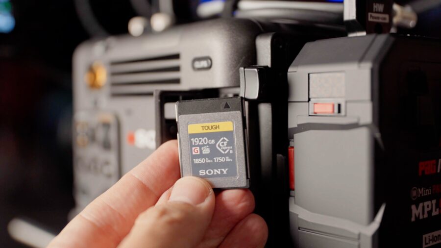

A breath of fresh air is also Sony’s choice to go with an industry standard as a recording medium: CF Express Type B is commonplace in cameras from Canon, FUJIFILM, Panasonic, and many others, and while Sony is late to the game, it’s great that they seem to have accepted that introducing proprietary card formats isn’t something people are looking for. The VENICE uses Sony’s proprietary AXS card standard, and a 1TB AXS memory card currently sells for over $4,000 on B&H, while the card reader (!) is still $3,870. Let that sink in.
Sony uses CF Express Type B on the BURANO. Yay for industry standards! Image credit: CineD
We don’t have that problem with CF Express Type B, where many reputable manufacturers make very fast memory cards at MUCH lower prices – for example, Angelbird. Sony also introduces their own CF Express Type B memory cards alongside the BURANO of course, and they will be 1920 GB and 960 GB large. Expect them to cost more than the equally fast options from the competition, as usual.

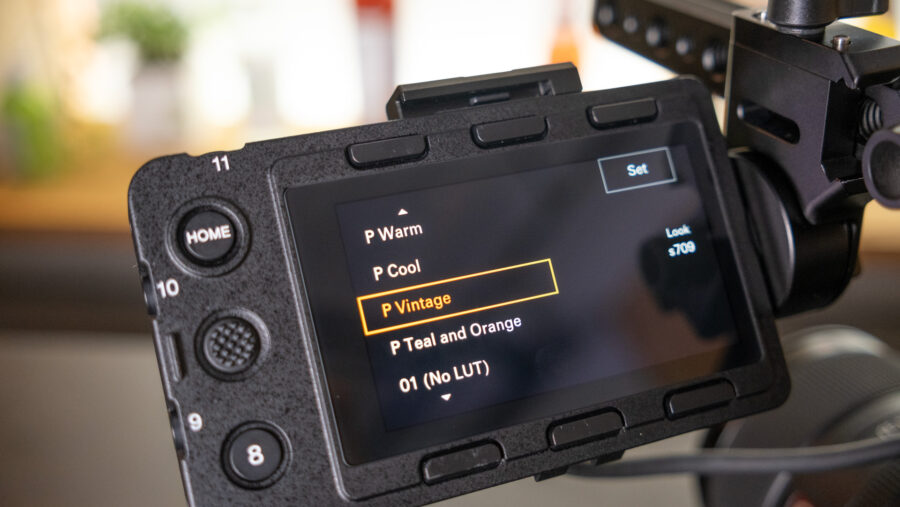

Yet in addition we get four new “cinematic looks” (preview LUTs) built into the camera which can be used in addition to the standard s709 and 709 preview LUTs: Warm, Cool, Vintage, Teal, and Orange. I tried out those preview LUTs quite a bit during the shooting at Pinewood Studios and I have to say, they look quite nice on preview monitors.
The new “cinematic looks” which can be used as preview LUTs on the Sony BURANO instead of a normal 709 look.

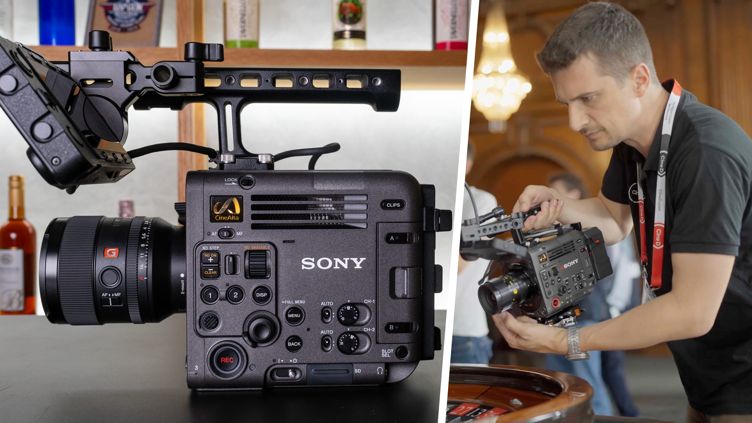

Compared to the VENICE 2, the BURANO is very small – it’s 32mm shorter and weighs only 2.85kg, which is 1.4kg lighter than the VENICE 2. After using it throughout an afternoon in London’s Pinewood Studios, I can say that it’s a very comfortable camera to use – it’s well balanced on the shoulder with a V-mount attached, all the settings are on the operator’s side, and it’s also comfortable to use while holding it by the top handle with your hand in front of your body.
The Sony BURANO feels very natural on the shoulder too, well balanced without the need of counterweights or anything like that
In a way, it’s a perfect mixture of the FX6 and FX9 handling – the FX6 really only works well held in front of your body (it has to be rigged up quite a bit to work well on the shoulder), and the FX9 really only works well on the shoulder (it’s too long for comfortable use in front of your body). The BURANO combines both of these approaches elegantly. The form factor actually reminds me more of a RED camera than a Sony.
The Burano is great for shooting handheld, and well-balanced

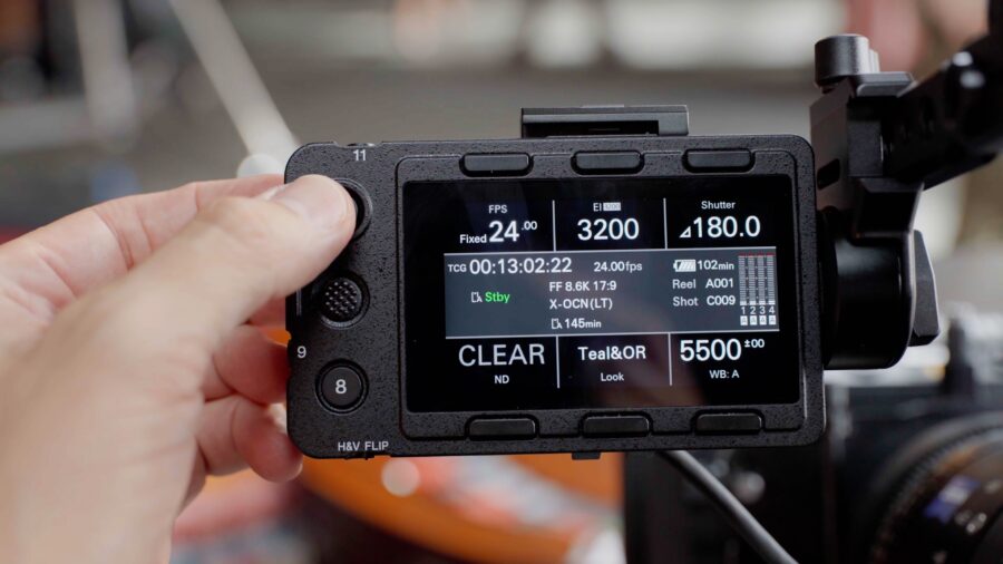

Included in the package with the Sony BURANO is a 3.5-inch LCD monitor that works for touch focus as well, and it doubles as a viewfinder when attaching the included loupe. The loupe itself is a mirror design which makes it sleeker than the one we have on the FX9 (and FS7) because it can stay closer to the body of the camera.
This loupe comes as part of the package of the Sony BURANO and is attached to the LCD screen when it’s mounted sideways to the camera.
It’s easy to attach and seems to be a much sturdier design than on the FS7/FX9, but of course, one wonders if they also thought about touch operation when the loupe is attached – it has to be taken off entirely to use touch focus (it can’t be flipped up, and the monitor is then attached to the side – not ideal.
The LCD has buttons all around for quick access to functions, which is welcome, and means the touchscreen will not be needed for menu operation.
When you press the “Home” button on the LCD, you get to this nice overview screen / quick menu to access the most important features fast.

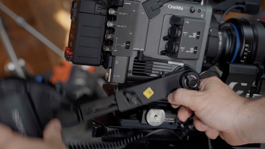

Not part of the package is a re-designed handle and grip that is an evolution of the FS7/FX9 handle and grip, and they enhanced one major point: the ARRI rosette doesn’t need to be unscrewed every time the angle of the grip is adjusted – a small lever allows for a quick adjustment. Still not as convenient as Shape’s quick-release system, but at least better than before. This handle and grip combination is an optional accessory, sold separately.
New quick release on the optional handle and grip for the Sony BURANO.
