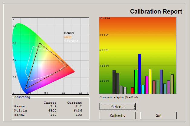

Sony KDL-46HX920 review.......................[flatpanelshd.com].............2011 flagship TV
http://www.flatpanelshd.com/review.php?subaction=showfull&id=1309426126
By Rasmus Larsen - 30 Jun 2011
Below are my calibrated settings.
After calibration
Picture mode: Cinema/Theatre
Backlight 7
Contrast 84
Brightness: 50
Colour: 50
Hue: 0
Sharpness: 0
Colour temperature Warm2
Noise reduction Off
Mpeg noise reduction Off
Dot Noise Reduction Off
Reality Creation Off
Smooth Gradation Off
Motionflow Clear Plus
Film-mode Auto 1/Auto 2
Black corrector Off
Adv. Contrast Enhancer Off
Gamma +1
LED Dynamic Control Standard
Auto Light Limiter Off
Clear White Off
Live Colour Off
Detail/Edge/ enha. Off
R Gain -3
G Gain -6
B Gain 0
R Bias -2
G Bias 0
B Bias +1
