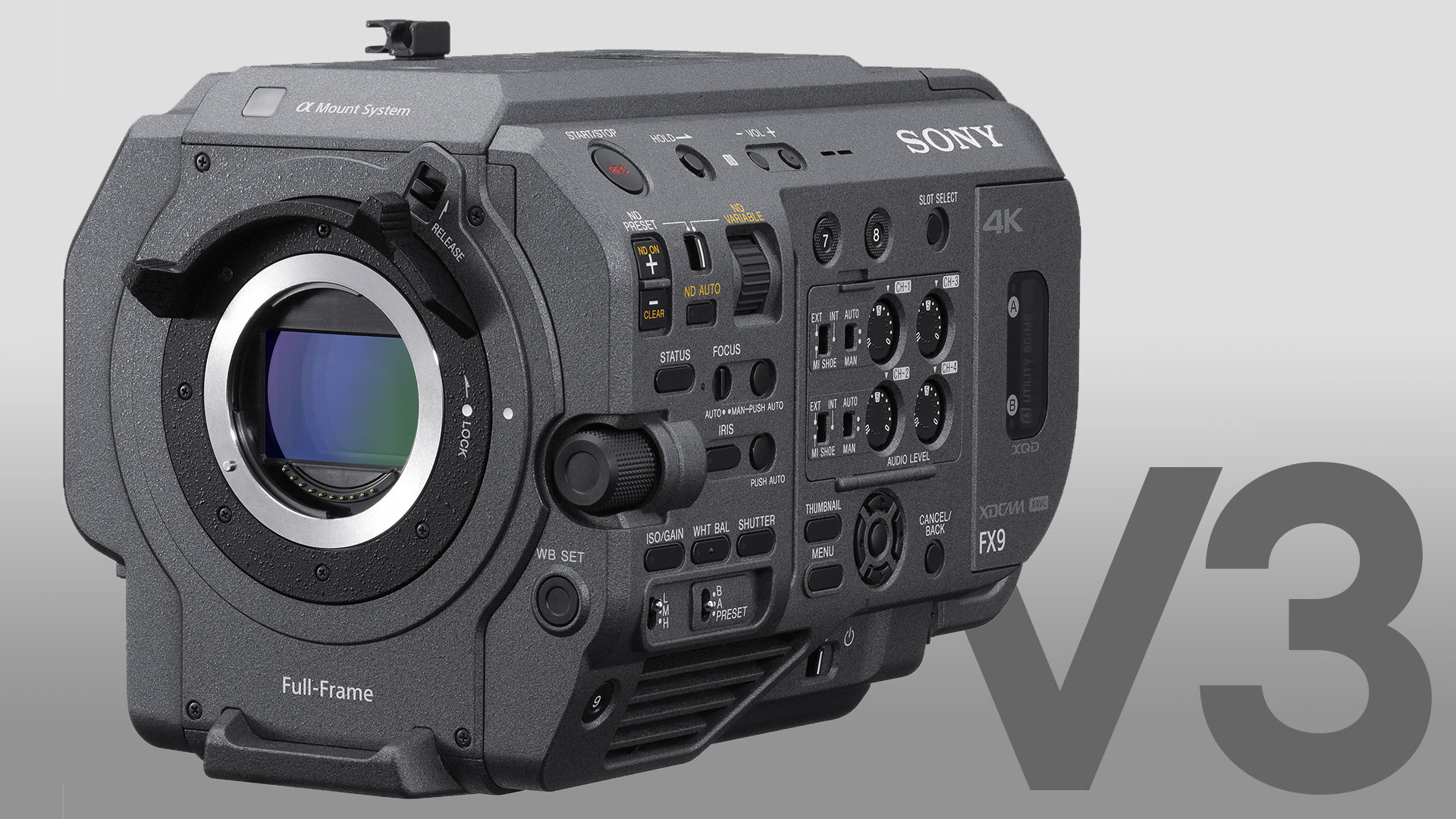

Sony PXW-FX9
CODEC: XAVC I
HDMI Output: Yes
Recording Media: SD card, XQD
Resolution: 6008x3168
SDI Output: Yes
Video Resolution: 4K
Lens Mount: Sony E
Sensor Resolution (Mega Pixels): 35.7MP
Sensor Size: S 35mm
Weight: 0-2kg
XLR Audio Input: Yes
FF αναβαθμιση της FS7 λοιπον αλλα οχι εσωτερικη εγγραφη RAW !!!!!

Key features of the new version include:
  • anamorphic lens support plus 2x desqueezing in the LCD viewfinder
  • S700PTP remote protocol for controling the camera over Ethernet
  • B4 lens support when using the Sony LA-EB1 adapter – S16 scanning mode (up to 1080p), lens control, and ALAC (auto lens aberration correction)
  • center scan mode switch on assignable buttons, allowing users to toggle seamlessly between different scan modes like with a Digital Extender known from camcorders such as the PXW-Z280 (FF6K – FF crop 5K – S35 – S16)
  • real-time tracking (touch tracking AF) allowing users to choose a focus point by touch on the LCD viewfinder and track its movement throughout the shoot
  • C3 portal support – quick connection to the cloud through a dedicated mobile app
  • clip naming (Cam ID + Reel number) – as known from the PXW-FS7
  • focus zero marker (numerically indicating focus gap from specific focus position during MF) enabling users to specify a point of focus in time and return to it at will
  • additional items can be modified in the Status Screen
  • SR Live for HDR metadata support
  • recording proxy clip real-time transfer
