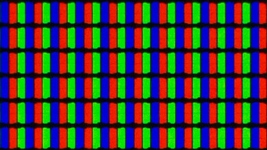

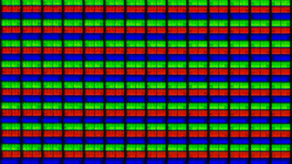

32"...[rtings.com]...Sony KDL-32W600D review...http://ca.rtings.com/tv/reviews/sony/w600d
KDL-32W600D (USA) ,η αντίστοιχη στην Ελλάδα είναι η KDL-32WD600.
Black : 0.116 cd/m2, White : 111.3 cd/m2, Contrast : 955 : 1 ,
KDL-32W600D:subpixel panel stucture,like PLS,IPS,ADSDS(Advanced Super Dimension Switch),

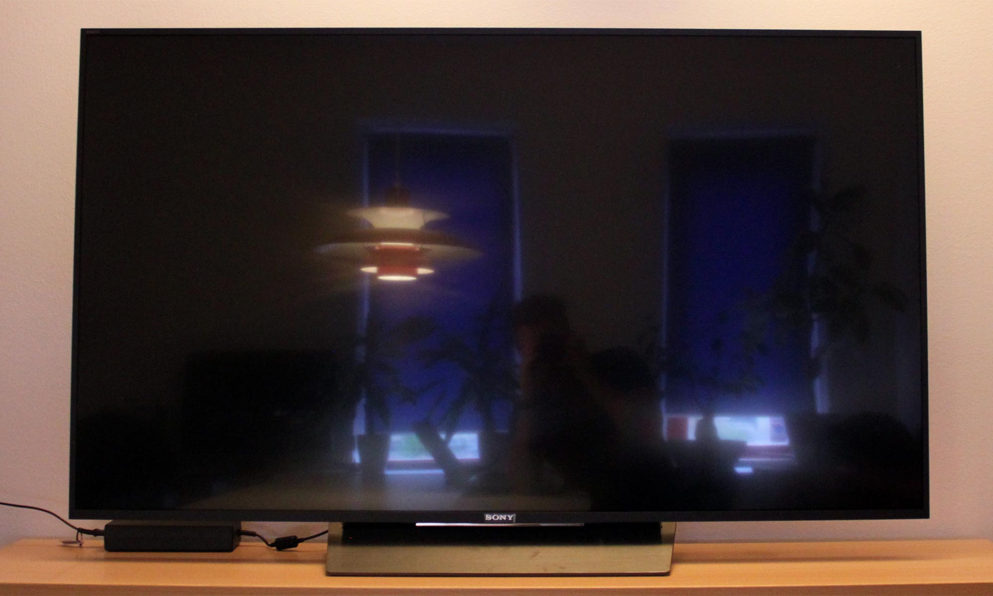

55"...[flatpanelshd.com]...Sony KD-55XD8599 review...http://www.flatpanelshd.com/review.php?subaction=showfull&id=1462946905
In Europe it will exist in three design variants named KD-XD8505B (black) ,KD-XD8577S (silver) , KD-XD8588B (black) and KD-XD8599B (black).

On paper Sony XD85 is the successor to last year’s top-seller X85C but in reality it is a much different TV. Sony has switched from a VA LCD panel in last year’s set to an IPS LCD panel in XD85, and it has obvious consequences. First and foremost, it means that Sony has sacrificed black levels for wider viewing angles.
Is that a good compromise? It depends on your habits. If you mostly watch TV during daytime or in a brightly lit room you will likely not be bothered much by the weak black levels, but if you mostly watch TV in the evening hours of the day you will surely notice that the picture lacks contrast and depth. On the other hand, the wide viewing angles are optimal for living rooms with multiple seating positions.
However, as a full package we think that picture quality is a clear downgrade compared to the predecessor. That is true even when you consider other factors such the expanded color gamut and support for HDR, which is a claim at best. To us, XD85 has little to do with HDR (high dynamic range) and if HDR is on your wish list you should seriously consider buying a full-array local dimming LCD TV instead – or better yet an OLED TV. XD93 is also a significantly better TV. XD85 is not a bad TV and its motion reproduction and relatively low input lag should be praised but the TV market is a competitive arena.
Android TV on the other hand has gotten better. Not because of faster hardware, because Sony has chosen to use the exact same chip, but because of software optimizations by Google. Built-in Chromecast is great and you can even use it when the TV is off. However, Android TV still has some ground to cover.
We had hoped that Sony would improve the 8 series through iteration. It could have become something great. Instead the company has created something entirely different. It feels a little too random. If you want a Sony TV we would recommend that you seriously consider buying XD93 instead – maybe that is exactly what Sony had in mind.
source photos:[flatpanelshd.com]

Σευχαριστω φιλε για τον πινακα. Αρκετα κατατοπιστικος. Για την sony xd80 που ενδιαφερομαι αναφερει οτι θα εχει περιορισμενο hdr. Μενει μονο να δουμε τι πανελ θα εχει? Ελπιζω va...
75"...[hdtvtest.co.uk]...Sony KD-75XD9405 review...http://www.hdtvtest.co.uk/news/kd75xd9405-201606164301.htm
Αντικαθιστά την Sony KD-75X9405C.
Αρχική ενδεικτική τιμή KD-75XD9405: 6.379 .
KD-75XD9405: macro shot of subpixel structure indicating VA-type LCD matrix,RGB.
...we counted 12 horizontal columns and 8 vertical rows, giving a total of 96 separately dimmable zones, which long-time readers will know is less than the 128 FALD zones implemented on its predecessor the KD-75X9405C
