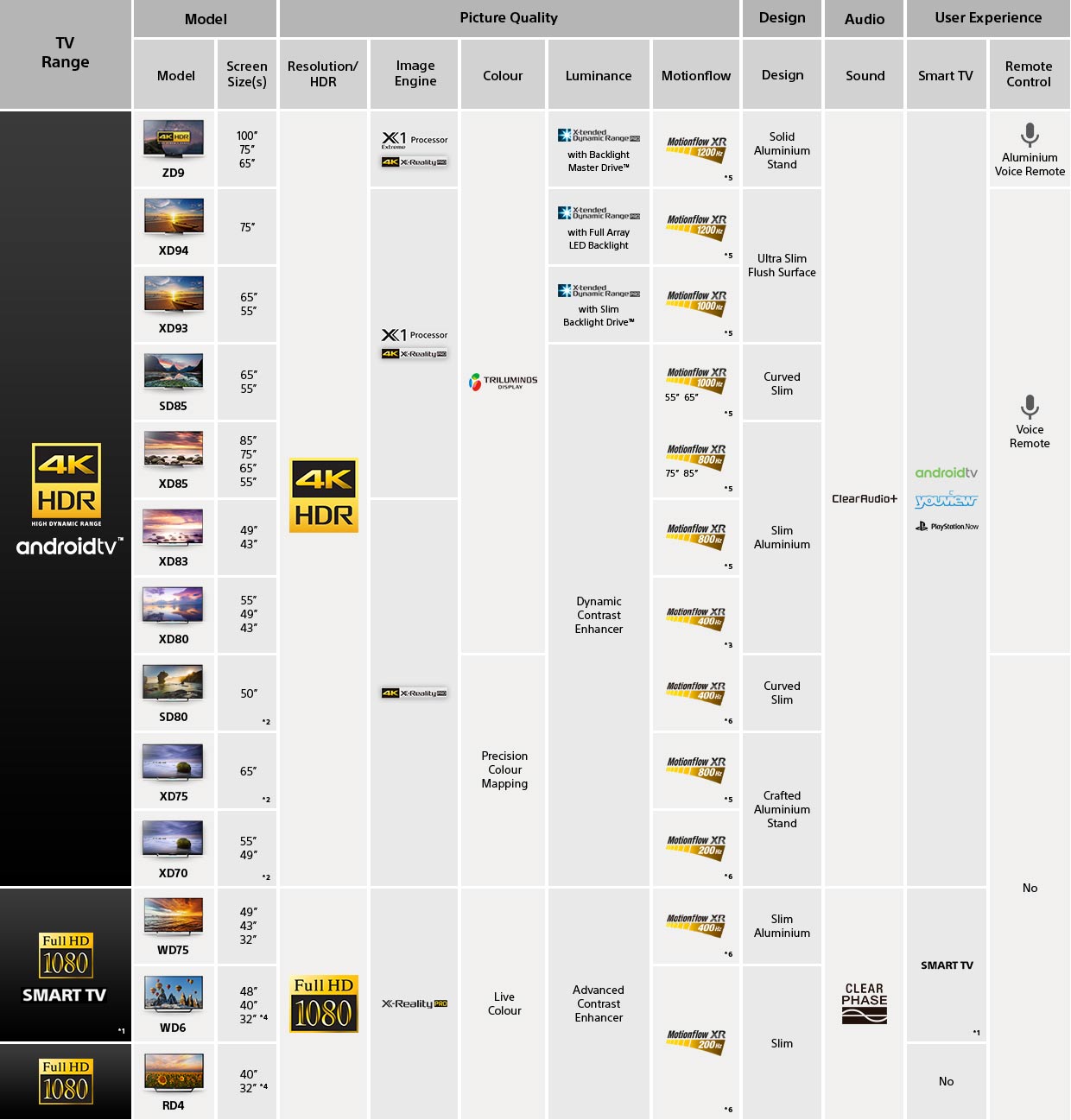

Sony Bravia tv line up 2016 table-update with September models.
source image:[currys.co.uk]

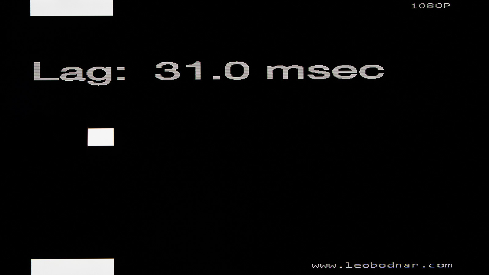

[TD]85" - Game mode 36ms / with MotionFlow 68ms
75" - Game mode 35ms / with MotionFlow 67ms
65" - Game mode 35ms / with MotionFlow 67ms
55" - Game mode 35.5ms / with MotionFlow 66.5ms
[/TD]

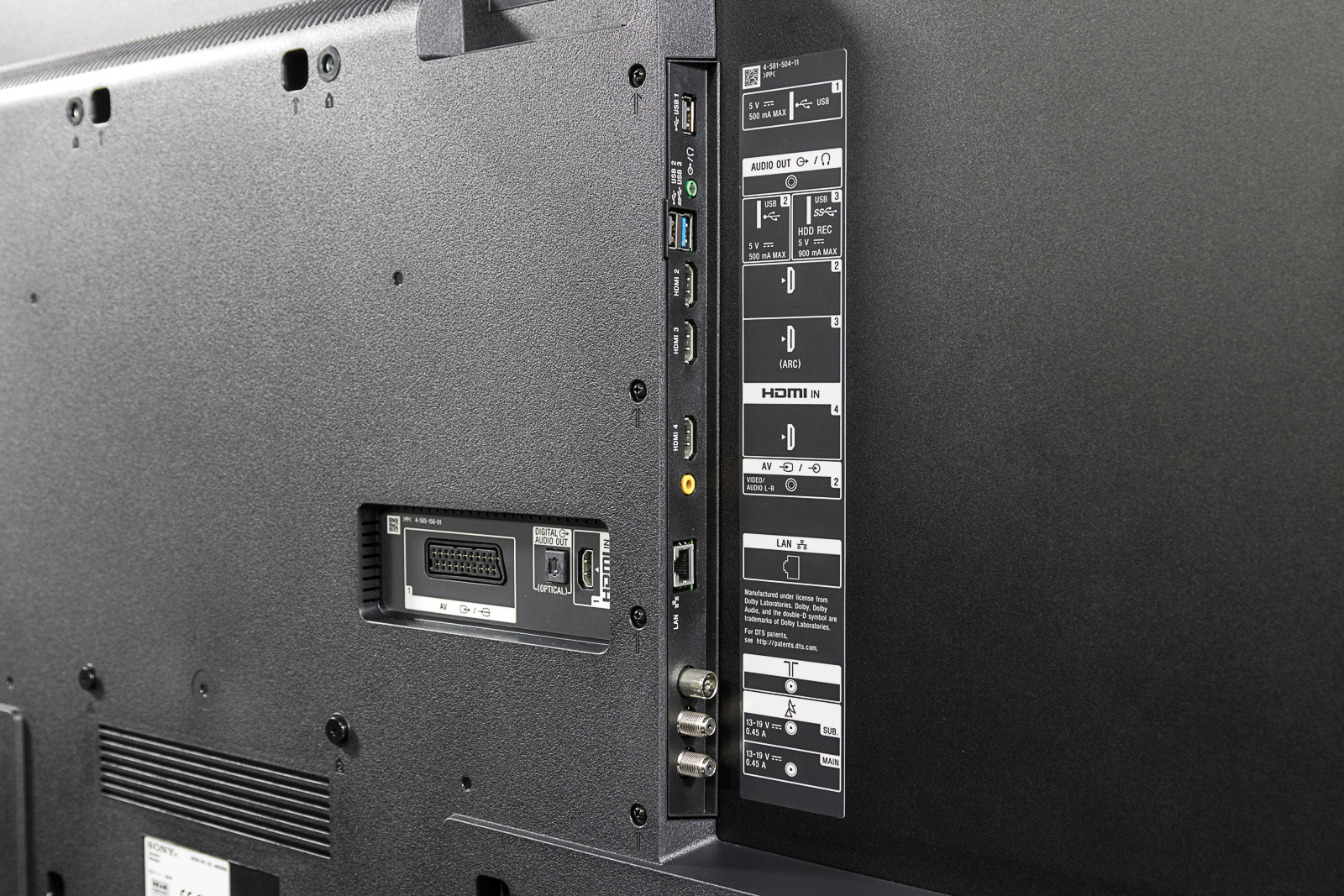

[TD]2 x USB 2.0 (DC 5V MAX 500mA)
1 x USB 3.0 (DC 5V MAX 900mA)
1 x Ethernet RJ45
4 x HDMI 2.0a - HDCP2.2 (ARC, CEC, MHL)
1 x Satelite In (Main: F-type female)-
1 x Satelite In (Sub: F-type female)
1 x SCART
1 x AV Composite In
1 x AV Component In
1 x Optical Audio Out (AAC/PCM/AC3)
1 x 3.5mm Audio Out
1 x Antena (RF) (female)
1 x CI+ 1.3
[/TD]

  • + Inputlag reduced (35ms) + Quick rΓ©mance time (9.6ms), excellent for play
