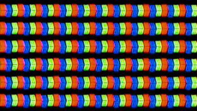

[TABLE="class: cms_table_cms_table_cms_table_cms_table_cms_table_cms_table"]
[TR="bgcolor: #000044"]
[TD="colspan: 11, align: center"]Sony OLED TV 2017 - european models[/TD]
[/TR]
[TR="bgcolor: #000066"]
[TD="align: center"]Series
Model
______________[/TD]
[TD="align: center"]Panel Type
__________________[/TD]
[TD="align: center"]bit of
__________[/TD]
Resolution
_________[/TD]
[TD="align: center"]Subpixel structure
_______[/TD]
[TD="align: center"]Panel frequency[/TD]
[TD="align: center"]MCFI
Motion Clarity Frame Interpolation
(s β„’)
________[/TD]
[TD="align: center"]BFI
(Black Frame Insertion)
____________
PWM
(Puls Wide Modulation)
[/TD]
[TD="align: center"]Type backlight
______________[/TD]
[TD="align: center"]HDR
____________[/TD]
Model
______________[/TD]
[/TR]
[TR]
[TD="bgcolor: #000099"]KD-77A1
[/TD]
[TD="align: center"]White AM-OLED
(LG Display)[/TD]
[TD="align: center"]10-bit[/TD]
[TD="align: center"]3840x2160[/TD]
[TD="align: center"]WRGB[/TD]
[TD="align: center"]120/100Hz[/TD]
[TD="align: center"]Yes
200 Hz[/TD]
[TD="align: center"]BFI - 50Hz[/TD]
[TD="align: center"]No[/TD]
[TD="align: center"]600 cd/m2
(HDR10 / HLG)[/TD]
[/TD]
[/TR]
[TR]
[TD="bgcolor: #000099"]KD-65A1
[/TD]
(LG Display)[/TD]
200 Hz[/TD]
(HDR10 / HLG)[/TD]
[/TD]
[/TR]
[TR]
[TD="bgcolor: #000099"]KD-55A1
[/TD]
(LG Display)[/TD]
200 Hz[/TD]
(HDR10 / HLG)[/TD]
[/TD]
[/TR]
[TD="colspan: 11, align: center"]Sony LCD TV 2017 - european models[/TD]
[/TR]
[TR]
[TD="bgcolor: #000099"]KD-100ZD9
[/TD]
[TD="align: center"]a-si TFT A-MVA
()[/TD]
[TD="align: center"]RGB[/TD]
200 Hz[/TD]
[TD="align: center"]BFI - 50 Hz
PWM - 600Hz[/TD]
[TD="align: center"]FALD
(1508 clusters (52 x 29))[/TD]
[TD="align: center"]1180 cd/m2
(HDR10 / HLG)[/TD]
[/TD]
[/TR]
[TR]
[TD="bgcolor: #000099"]KD-75ZD9
[/TD]
(AUO)[/TD]
200 Hz[/TD]
PWM - 600Hz[/TD]
(858 clusters (39 x 22))[/TD]
(HDR10 / HLG)[/TD]
[/TD]
[/TR]
[TR]
[TD="bgcolor: #000099"]KD-65ZD9
[/TD]
(AUO)[/TD]
200 Hz[/TD]
PWM - 600Hz[/TD]
(646 clusters (34 x 19))[/TD]
(HDR10 / HLG)[/TD]
[/TD]
[/TR]
[TR="bgcolor: #800080"]
[TD="colspan: 11, align: center"]XE94[/TD]
[/TR]
[TR]
[TD="bgcolor: #000099"]KD-75XE940
[/TD]
[TD="align: center"]a-si TFT MVA
()[/TD]
200 Hz[/TD]
PWM - 600Hz[/TD]
(256 zones (16x16))[/TD]
[TD="align: center"]1440 cd/m2
(HDR10 / HLG)[/TD]
[/TD]
[/TR]
[TD="colspan: 11, align: center"]XE93[/TD]
[/TR]
[TR]
[TD="bgcolor: #000099"]KD-65XE930
[/TD]
()[/TD]
200 Hz[/TD]
[TD="align: center"]BFI - 100Hz
PWM - 800Hz[/TD]
[TD="align: center"]Edge LED
( 72 zones (18x4))[/TD]
[TD="align: center"]1500cd/m2
(HDR10 / HLG)[/TD]
[/TD]
[/TR]
[TR]
[TD="bgcolor: #000099"]KD-55XE930
[/TD]
()[/TD]
200 Hz[/TD]
PWM - 800Hz[/TD]
(64 zones (16x4))[/TD]
(HDR10 / HLG)[/TD]
[/TD]
[/TR]
[TR]
[TD="colspan: 11, align: center"]XE90[/TD]
[/TR]
[TR]
[TD="bgcolor: #000099"]KD-75XE9005
[/TD]
(Samsung)[/TD]
200 Hz[/TD]
PWM - 600Hz[/TD]
(55 zones ??)[/TD]
[TD="align: center"]500cd/m2
(HDR10 / HLG)[/TD]
[/TD]
[/TR]
[TR]
[TD="bgcolor: #000099"]KD-65XE9005
[/TD]
()[/TD]
200 Hz[/TD]
PWM - 600Hz[/TD]
(45 zones)[/TD]
(HDR10 / HLG)[/TD]
[/TD]
[/TR]
[TR]
[TD="bgcolor: #000099"]KD-55XE9005
[/TD]
()[/TD]
200 Hz[/TD]
PWM - 600Hz[/TD]
(35 zones)[/TD]
(HDR10 / HLG)[/TD]
[/TD]
[/TR]
[TR]
[TD="bgcolor: #000099"]KD-49XE9005
[/TD]
()[/TD]
200 Hz[/TD]
PWM - 600Hz[/TD]
(25 zones ??)[/TD]
(HDR10 / HLG)[/TD]
[/TD]
[/TR]
[TD="colspan: 11, align: center"]XE85 - XE8505 / XE8577 / XE8588 / XE8596 / XE8599 Series
[/TD]
[/TR]
[TR]
[TD="bgcolor: #000099"]KD-75XE85[/TD]
[TD="align: center"]a-si TFT S-IPS
(LG Display)[/TD]
[TD="align: center"]10-bit ?[/TD]
Hz[/TD]
PWM - 0Hz[/TD]
(No)[/TD]
[TD="align: center"]400cd/m2
(HDR10 / HLG)[/TD]
[/TR]
[TR]
[TD="bgcolor: #000099"]KD-65XE85[/TD]
()[/TD]
Hz[/TD]
PWM - 0Hz[/TD]
