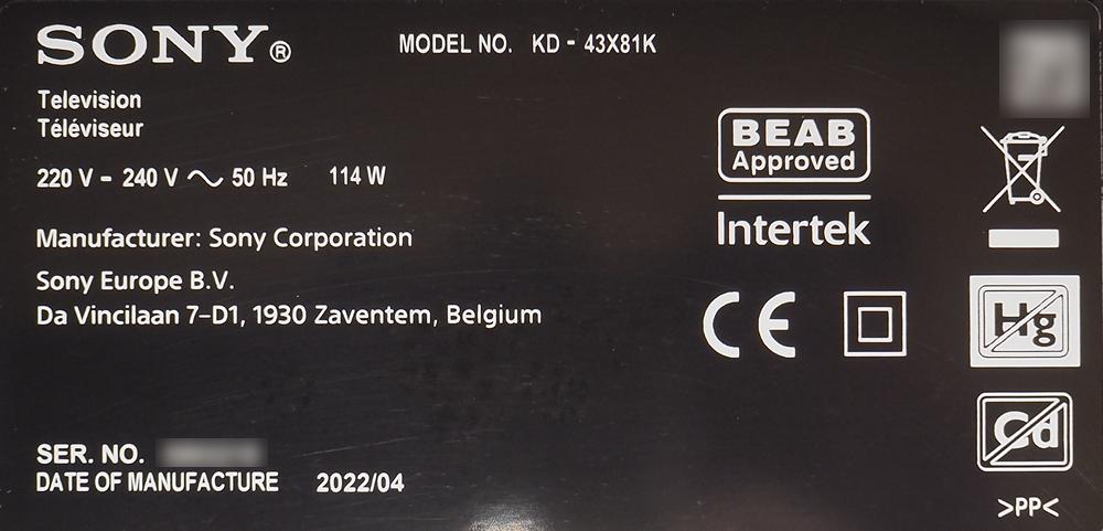

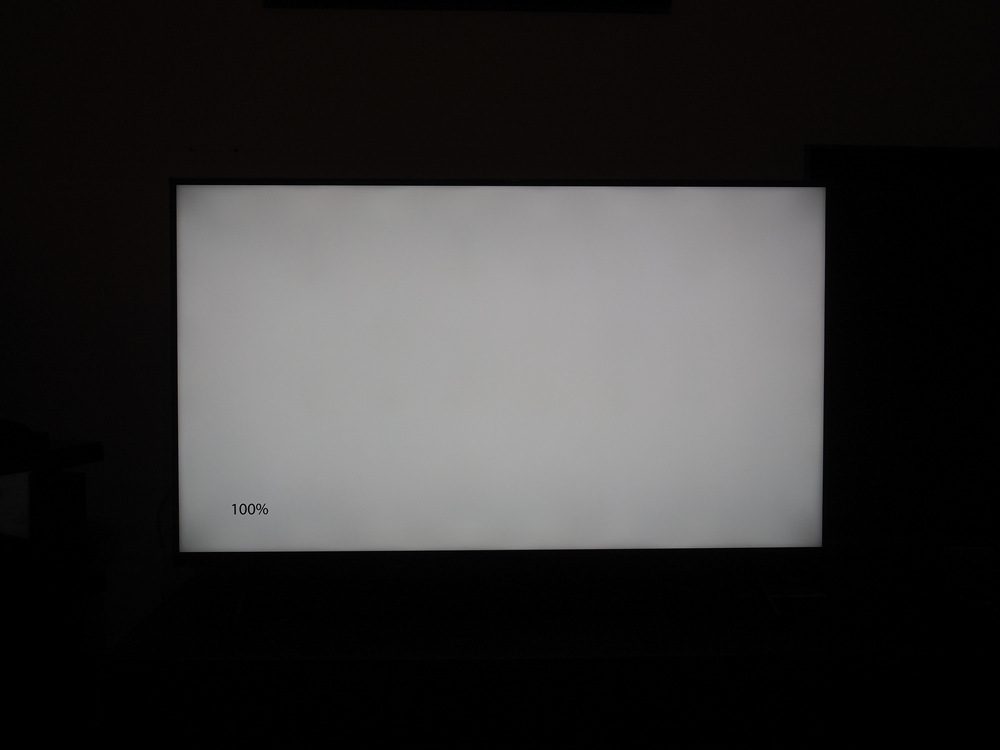

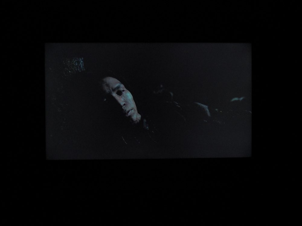

43"...[geex.x-kom.pl]...Sony KD-43X81K review...https://geex.x-kom.pl/recenzje/test-i-recenzja-telewizora-sony-43x81k/
αντικαθιστά την 43X81J

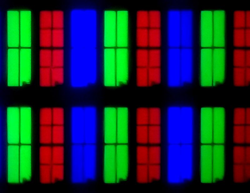

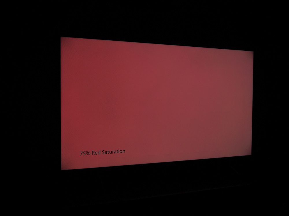

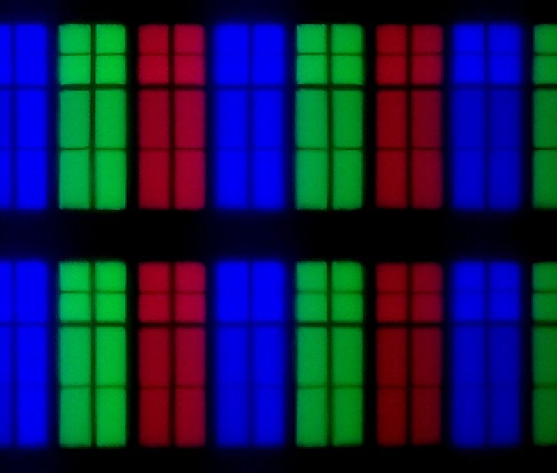

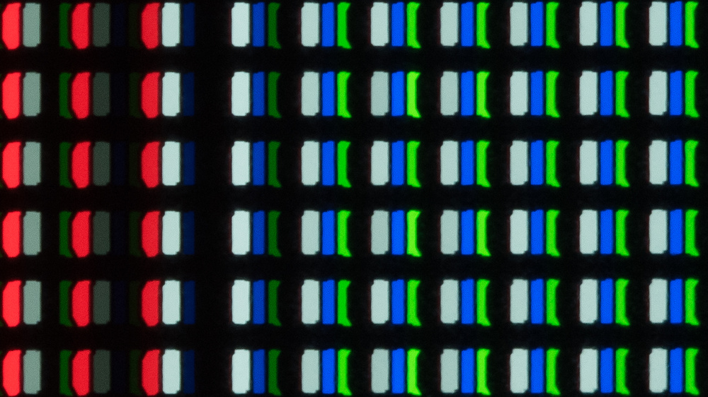

type panel : ADS ,όπως IPS = ANSI contrast ratio was only 1000:1
Panel technology : LCD

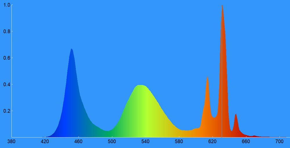

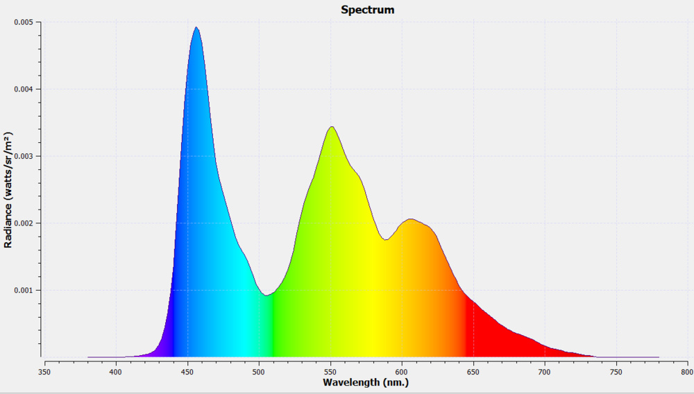

Backlight : Direct LED
50/60Hz
DCI-P3 space (CIExy) : 91%
And a few final remarks:

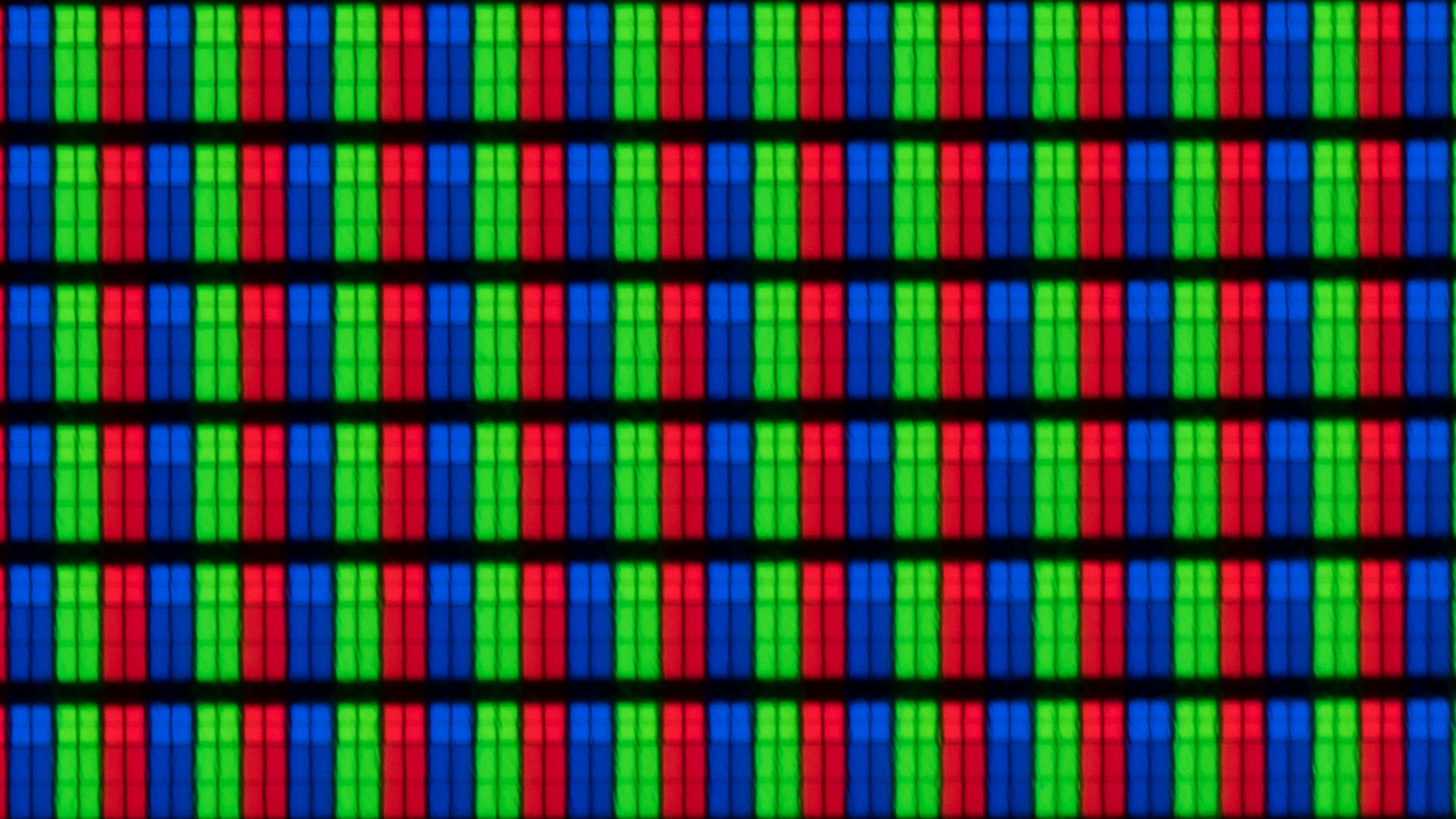

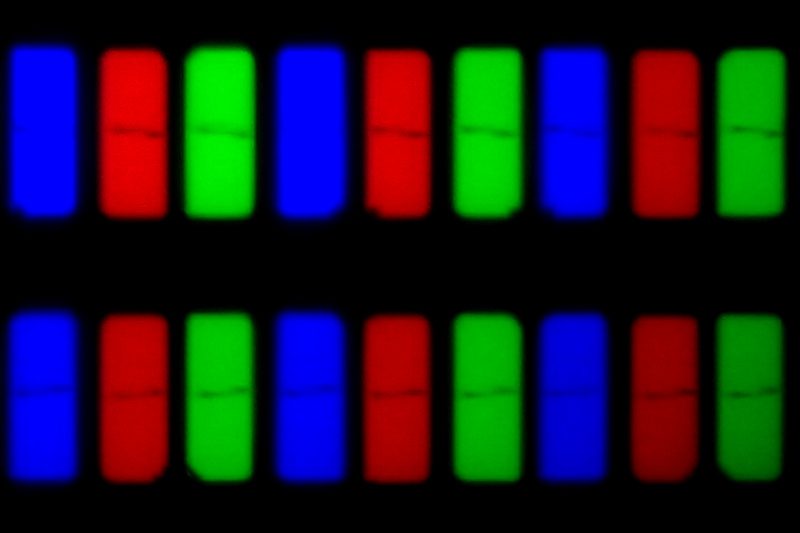

65"...[rtings.com]...Sony KD-65X85K (USA model) review...https://www.rtings.com/tv/reviews/sony/x85k
αντικαθιστά την KD-65X85J του 2021

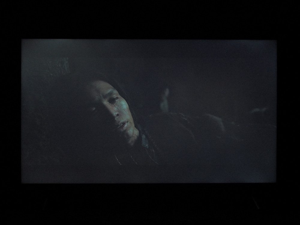

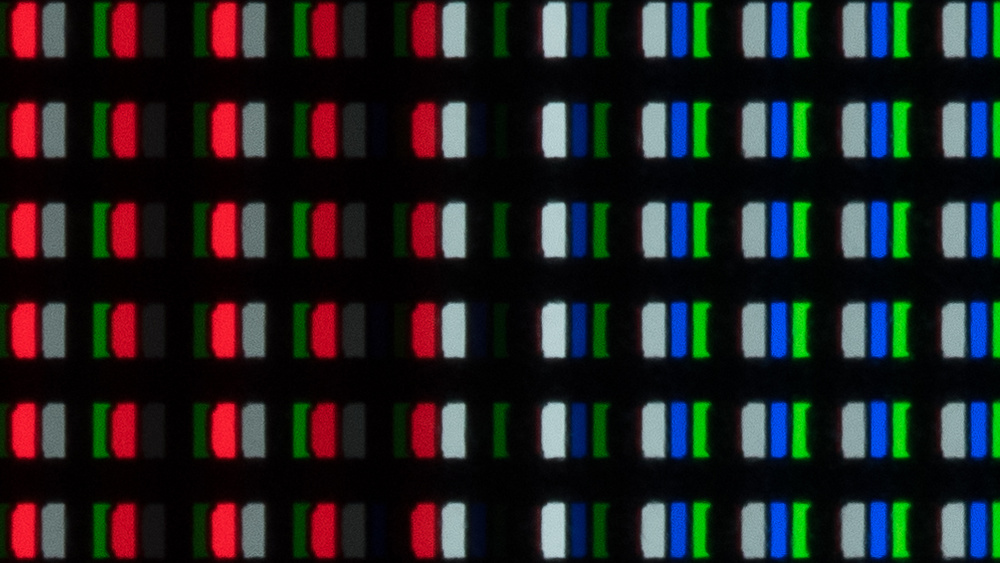

η ευρωπαϊκή KD-65X85K είναι με ADS/IPS panel

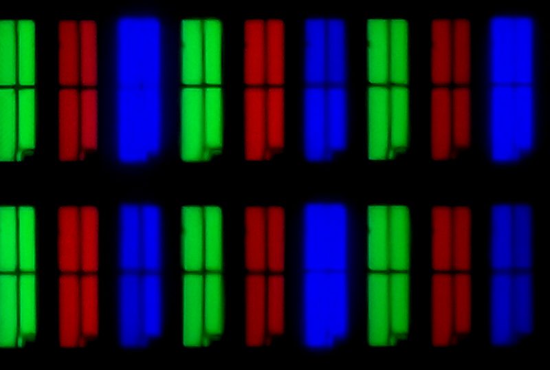

type panel : VA = native contrast ratio 5000 : 1,RGB,8 domain,vertical stripe.
panel technology : LCD,transmissive

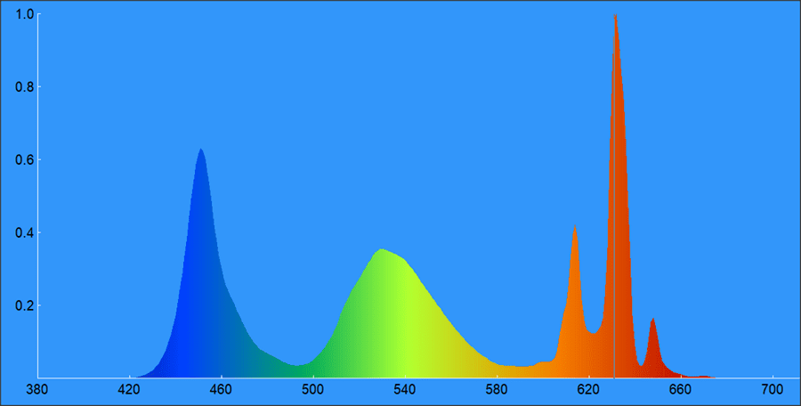

Backlight: direct-lit LED
100/120Hz με MCFI + αναβόσβησμα του οπίσθιου φωτισμού

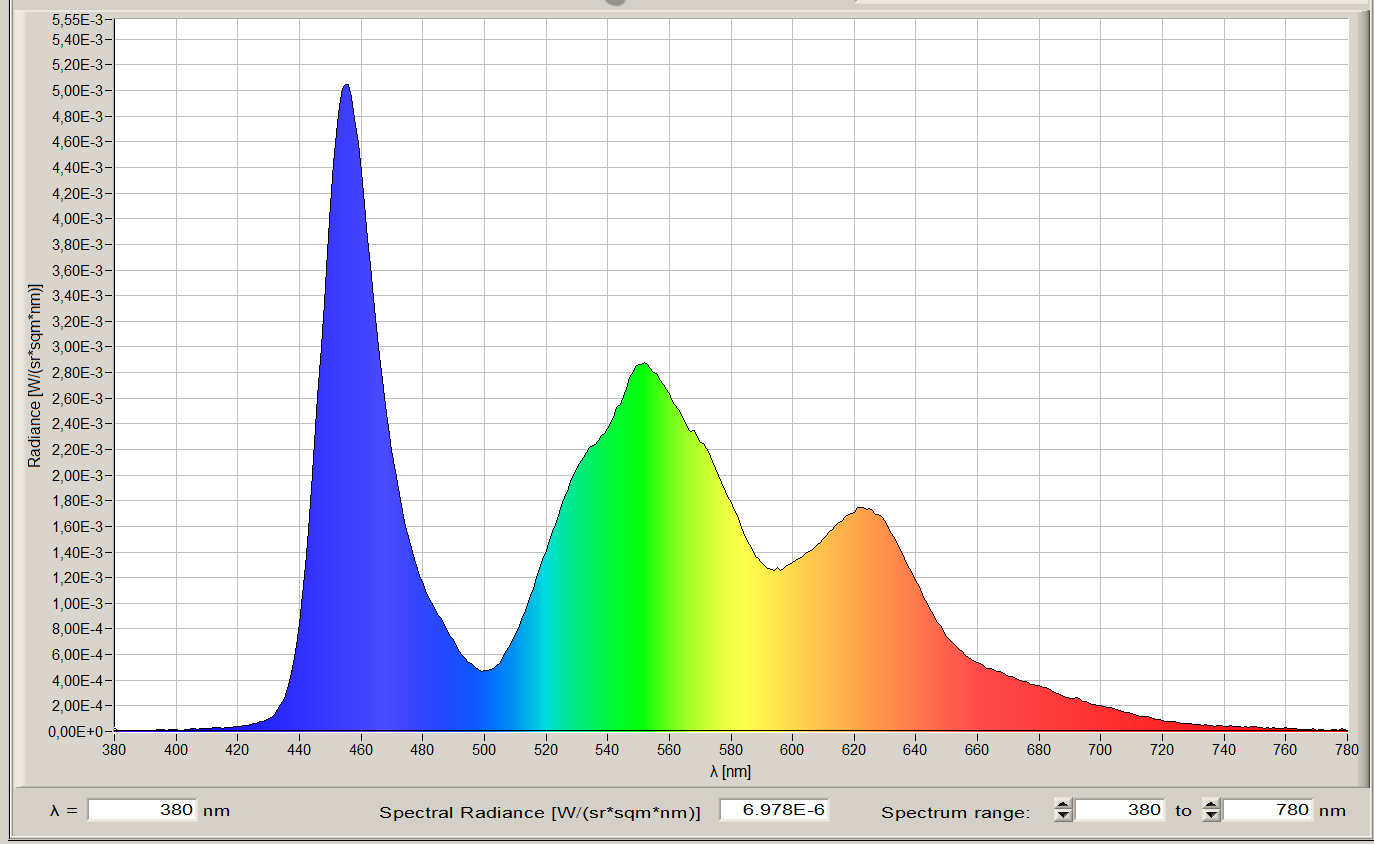

DCI P3 xy : 91.99%
DCI P3 uv : 95.80%

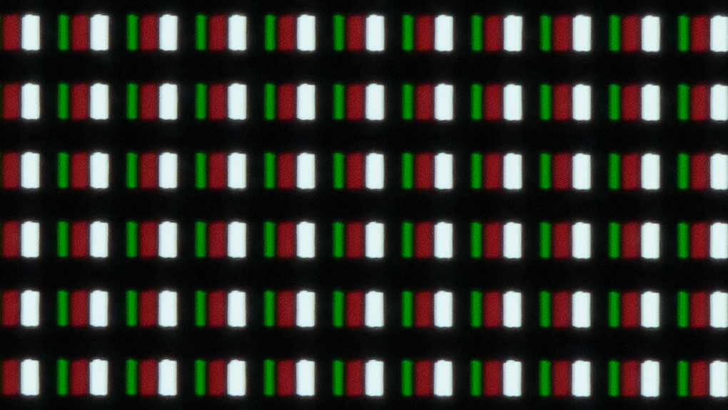

55"...[avmania.zive.cz]...Sony XR-55A95K review...https://avmania.zive.cz/recenze-tel...k-nejlepsi-obraz-diky-qd-oled-vam-vyrazi-dech

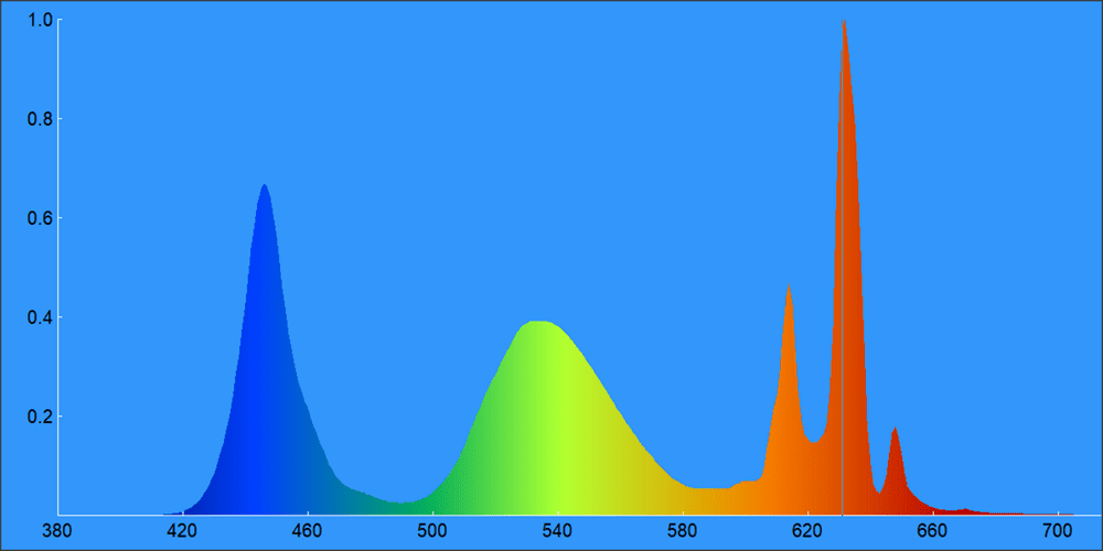

50/60Hz

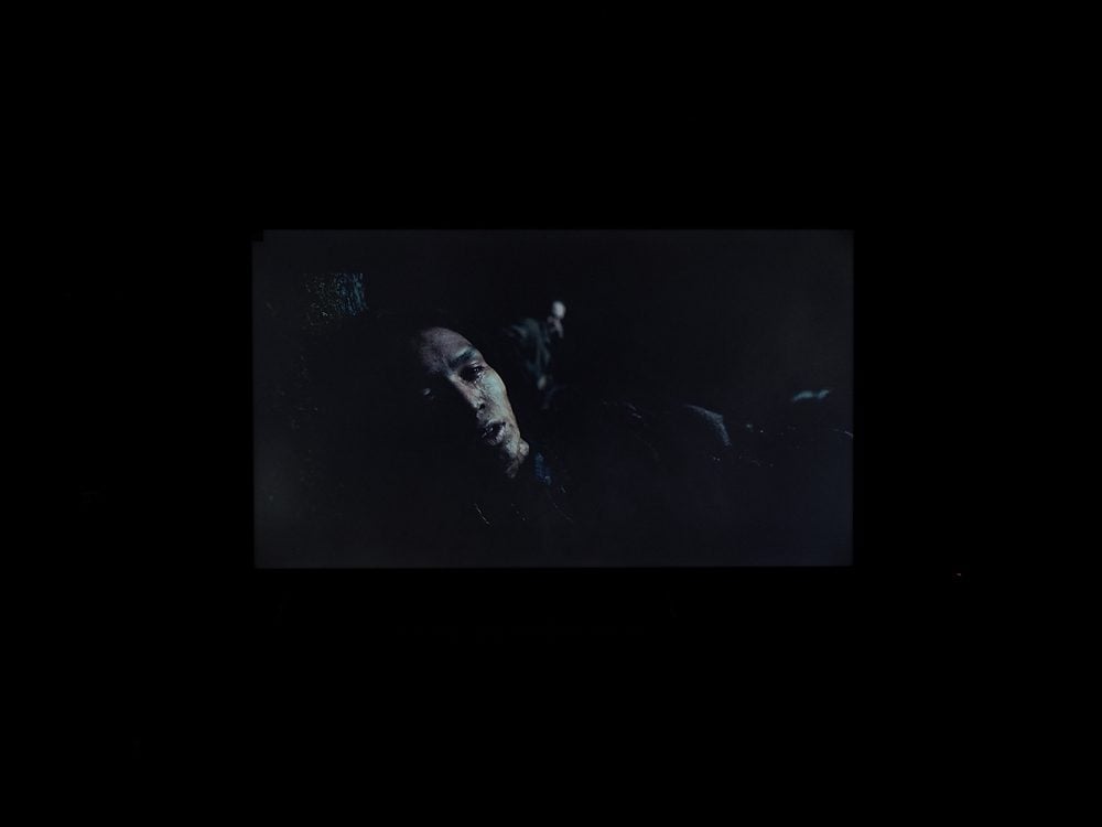

- black level you need to give from 50 to 51;
- the TV does not use dynamic global dimming;
- the white level (contrast) was factory set to 90, and the TV loses details in the lights; unfortunately, the reduction of "contrast" does not help;
- the "advanced contrast enhancement" (ZZK) function is pre-activated in the "small" option and falsifies the brightness curve, therefore I advise you to disable it.

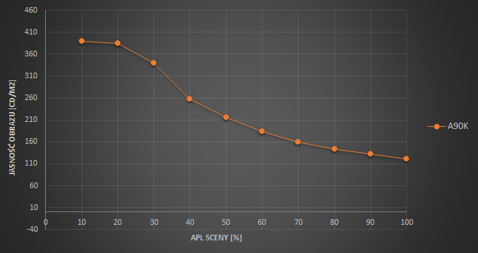

HDR
In the User mode on the board 10%, the maximum luminance after three minutes of measurement was stable and amounted to 411 cd/m² (nits), i.e. about 12 candelas more than in the predecessor(43X80J).
