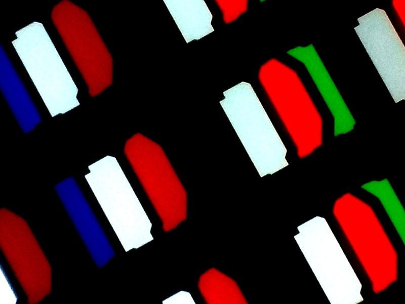

27” in size (more precisely 26.5″) ,flat.
MLA+ (META technology 2.0) WOLED panel by LG Display (new RGWB subpixel layout) + passive cooling system, with a custom heatsink.

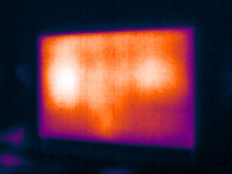

A custom thermal system in the INZONE M10S
Heat sinks efficiently channel the thermal output from the high-bandwidth ASIC panel controller and video processor, up and away from the OLED panel, ensuring consistent brightness and efficient operation.

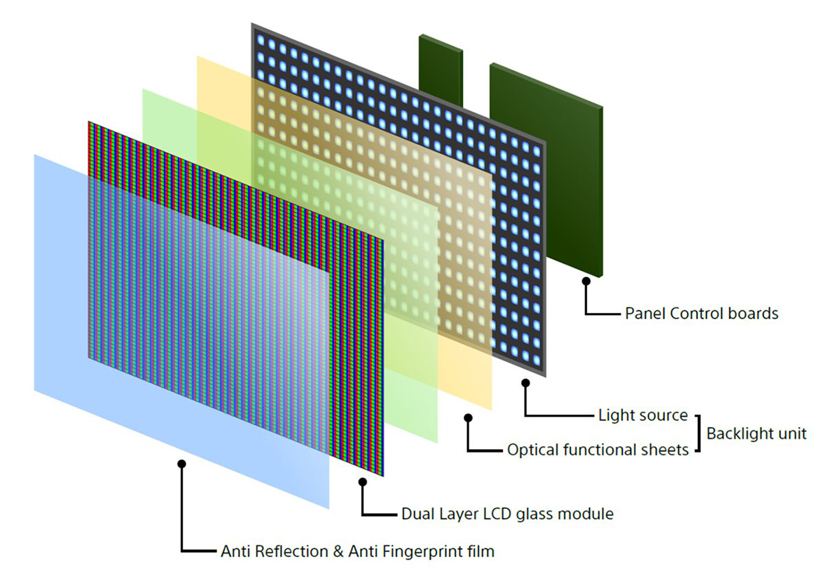

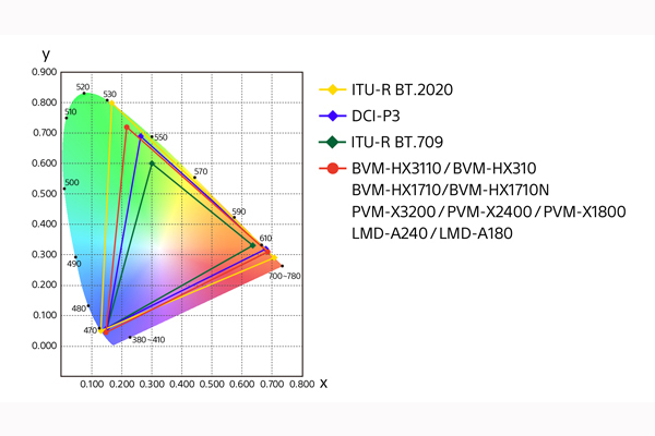

[hdtvtest.co.uk]...Sony has launched a new 16-inch BVM-HX1710 4K professional master monitor at IBC 2024 in Amsterdam, which must be the smallest dual-layer LCD monitor in the world.
Dual-layer LCD monitors use two layers of LCD panels to achieve self-emissive properties, delivering supremely deep blacks and very high brightness, but high costs and energy consumption mean that they won't be coming to the consumer realm anytime soon.
Dual layer / Light Modulating Cell layer LCD
16.5-inch 4K TRIMASTER HX Professional Master Monitor

Direct mini LED FALD LCD
100/120Hz με MCFI+αναβόσβησμα του οπίσθιου φωτισμού
VA panel + viewing angle compensation film + antireflection filter
1920 dimming zones

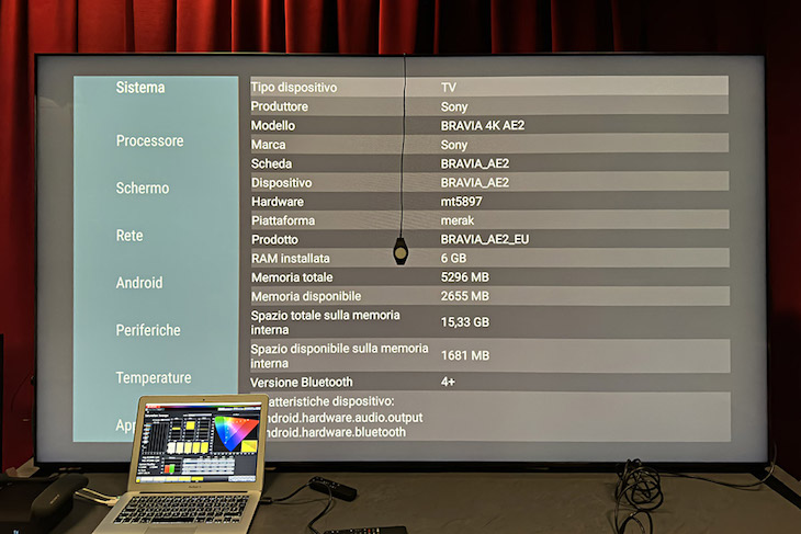

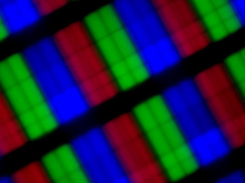

Mediatek Pentonic 1000 chipset
SoC : MediaTek mt5897
Model : BRAVIA 4K AE2
Platform : merak
CPU : 4x ARM-Cortex-A73 @ 2000MHz ,CPU Clock Range : 900 - 2000 MHz.
GPU : ARM Mali-G57
RAM : 6 GB
Total storage-On-board Storage : 32GB - expandable via USB
Internal Storage Total Space (o πραγματικός χώρος αποθήκευσης θα διαφέρει λόγω της εγκατάστασης λογισμικού) : 16,29 GB
Screen Resolution User Interface Android TV : 3840x2160
Android version : 12 Snow Cone
(Sony A95L Mediatek Pentonic 1000 chipset, new 2023 SoC : mt5897 ,Model : BRAVIA 4K AE1,platform : merak)
