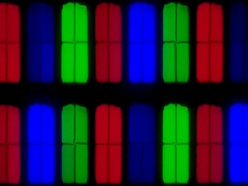

Display technology : LCD
Type LCD : VA panel, 4 domain,vertical stripe RGB
At a horizontal angle, the colors fade quite strongly, which is partly due to the "merit" of the selected panel, which has only 4 domains per subpixel, and not 8, as in the best rivals.

At a horizontal angle, the colors fade a lot, which is due to the matrix used, which has only four domains per subpixel, and not six or eight – as in the best solutions.

At a horizontal angle, the colors fade quite strongly, which is partly due to the "merit" of the selected panel, which has only 4 domains per pixel, and not 8.
