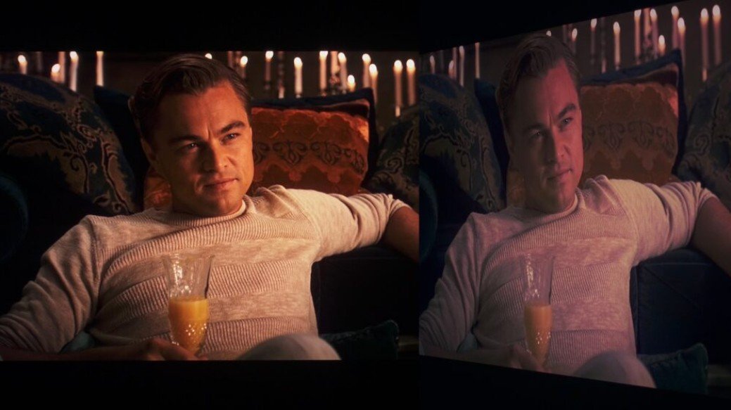

1680 dimming zones (56×30 dimming zones)
