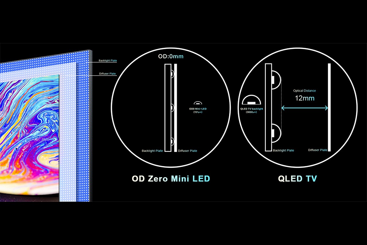

TCL has unveiled its latest-generation Mini LED backlight technology called "OD Zero", which refers to how the company's engineers have compressed the optical distance between the top of the Mini LED backlight and the bottom surface of the diffuser plate to zero.
TCL's OD Zero Mini LED backlight offers five key advantages:
1) Thinner TVs
2) More local dimming zones
3) Higher peak brightness
4) Improved backlight uniformity
5) Better reliability

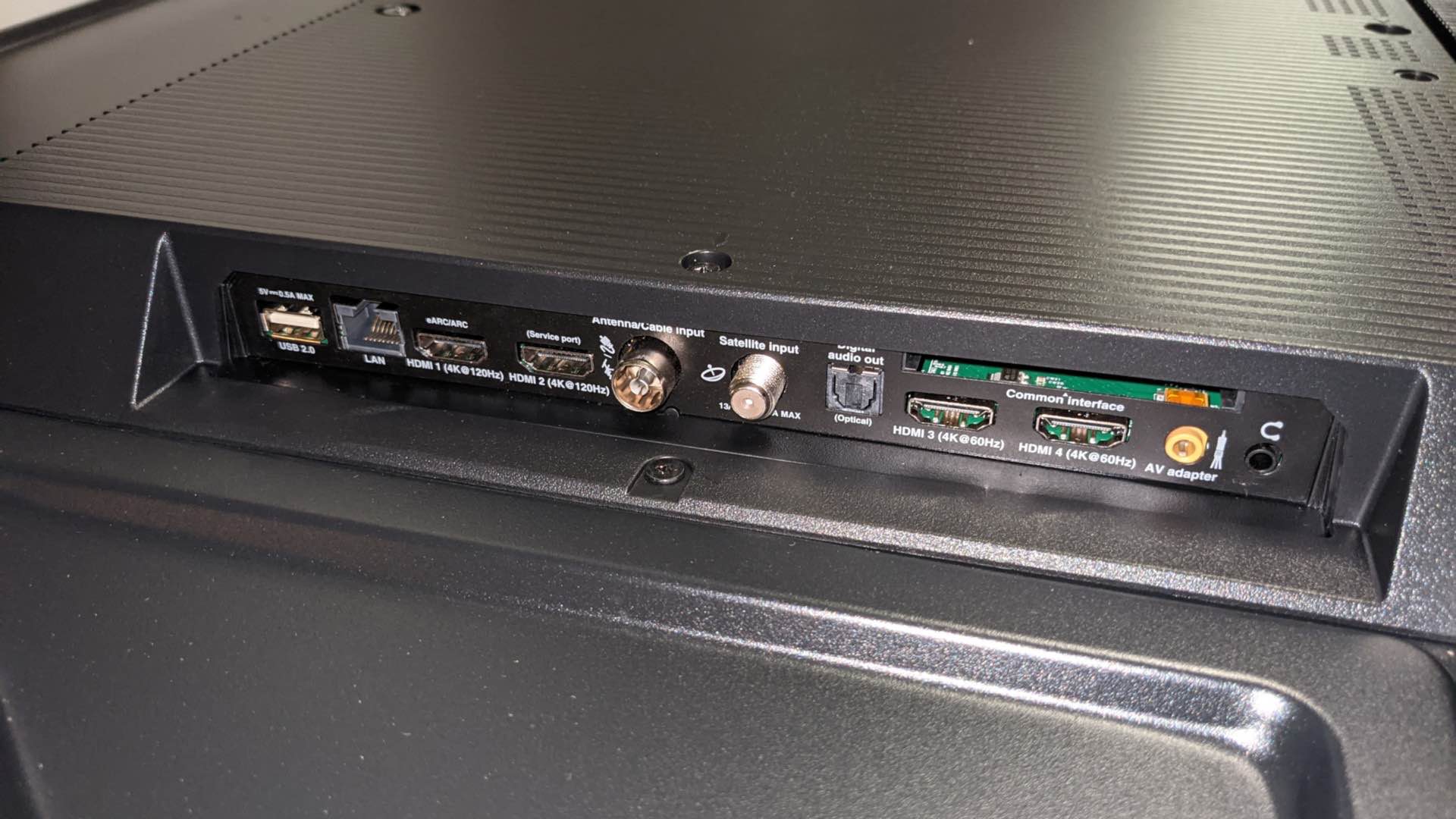

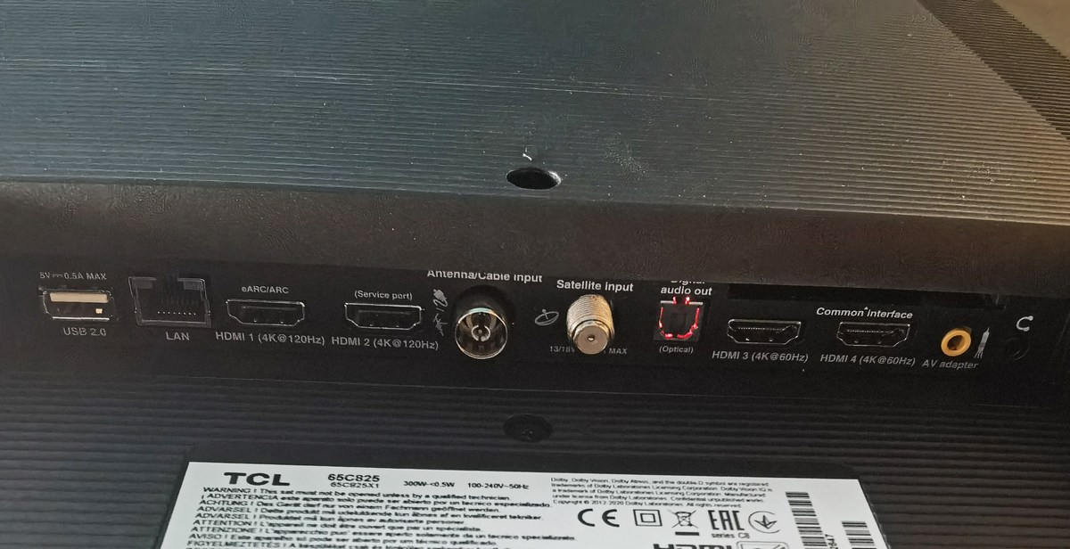

-TCL 65C825 first Look and unboxing
model 65C825X1

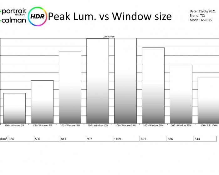

65"...[fwd.nl]...TCL 65C825 review...https://fwd.nl/beeld/review-tcl-65c825-lcd-led-tv-rijk-uitgerust-en-veelbelovend/
65C825 : VA panel-8 domain,RGB,vertical stripe
Mini-LED FALD LCD, 16x10 zones =160 zones
wide color gamut DCI-P3 coverage: yes
HDR

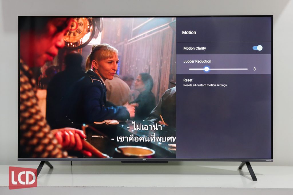

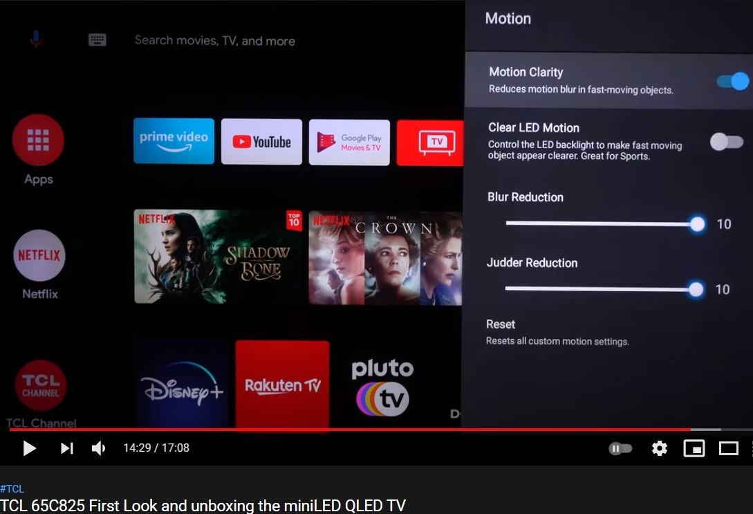

Motion Clarity : On
LED Motion Clear: Off/On
Blur reduction : 10
Judder reduction : 4-10

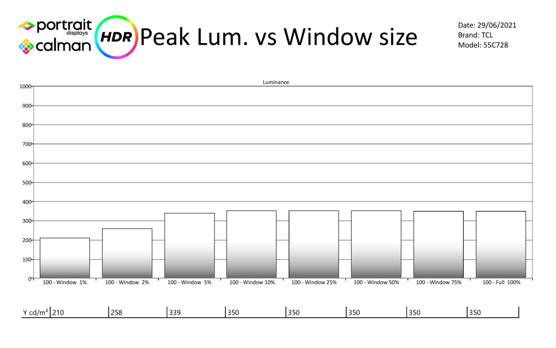

55"...[prohardver.hu]...TCL 55C728 review...https://prohardver.hu/teszt/tcl_c72_kozepkategorias_qled_teve/tcl_c72.html
55C728 provided by the Hungarian representative of TCL
