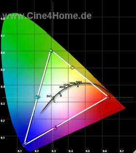

So far so good , now we move on to the color space analysis : The classic color triangle shows that the primary colors are matched in saturation and hue very well on the video standard :
Perfectly balanced color space
according to video standard

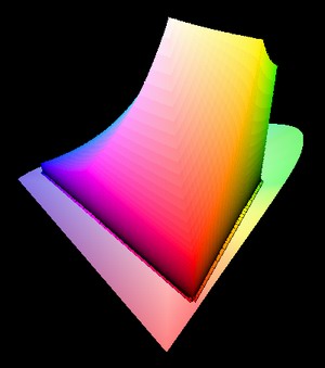

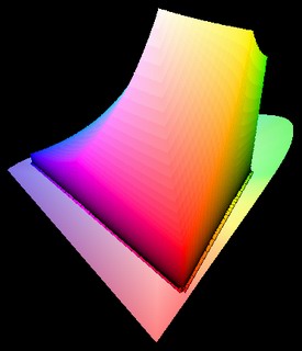

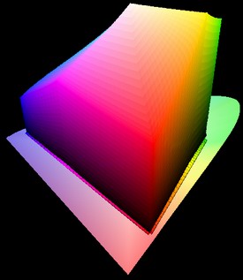

The " Color Light Output " But we can only refer to the three-dimensional representation of the color space :
This shows that the color space is spanned evenly with bright colors and added to the " White Peak " in the middle. This causes a bright color display .

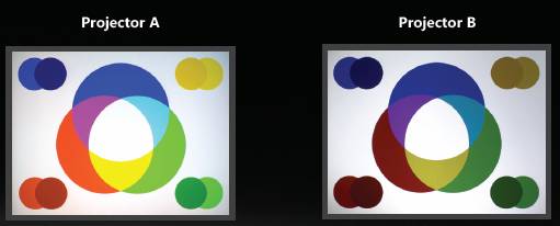

4.2 Projector B ( 1Chip entry device)
As a " projector B" , we consider a reasonable presentation projector with 1-chip DLP technology and white segment in the color wheel . For a very reasonable price , the manufacturer promises 2500 lumens light output even here .
Conventional measurement with white image
We repeat the first measurement using a standard white image and actually reaches the projector in the promised White Light Output of 2500 lumens , the manufacturer has so do not lie. He, too, but did not mention that the calibration costs valuable light on the video standard is around 1650 lumens remain correct color temperature. But this is a slightly higher light output than with projector A, this model should be better?

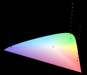

Color Light Output measurement
Brings clarity only the measurement of Color Light Output using the primary colors : 850Lumen for green, 250Lumen for red and blue for 80Lumen add up to only 1180 lumens. This proves that not all of the brightness of the projector is converted into bright colors, but only about two-thirds .
With the classic color triangle , this difference can , however, do not represent , because our 1Chip projector displays perfectly matched saturation and hues of the primary colors. The fact that the actual color space of the projector smaller fails, you can see only in the three-dimensional representation :
Here you can see that although the white level is very high, the actual color but are very " dark " in relation thereto .

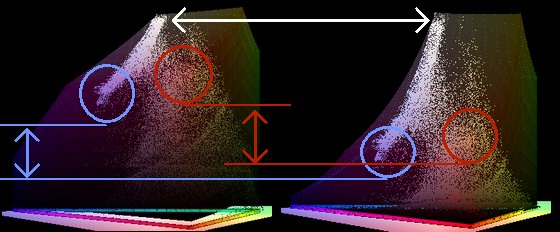

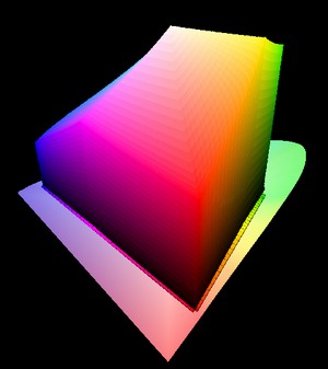

In order to compare these findings and their implications for image display vivid , let's look more closely at the color space . In the three-dimensional view of the brightness of the primary colors is clear :
Top: color level of projector A
Bottom: color level from projector B
On these charts you can see directly how much more light reaches projector A in the primary colors red , green and blue. This difference will be consequently in the volume of noticeable color spaces :
Top: color space of projector A
Bottom: color space of the projector B
Here you can see how although comparable brightness in the white point can be achieved , but this at the 1Chip projector with white segment in the color wheel with increasing saturation drops much steeper . This applies to all primary and secondary colors :
Each left: color level of the 3-chip projector
To the right : 1Chip projector with white segment

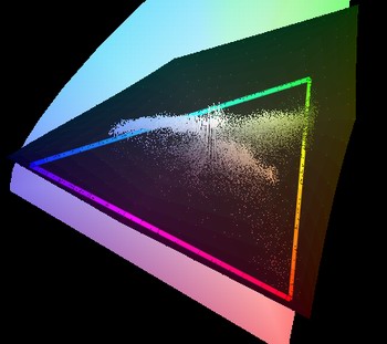

Our " demo recording " is a classic design with natural colors (trees / sky) and high contrast without color ( clouds). All common colors of the image are marked by dots in the diagram below :
All shades of the image in the color space

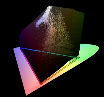

It is easily seen that the image contains vast bright blue, orange and greens without too high saturation. If we now compare the two projectors directly with each other , it becomes clear different bright as they represent these colors :
Links : Color and white level of projector A
Right: B Projector
The above color analysis shows the direct comparison, while the white level ( the clouds ) the same height is two projectors , succeeds much brighter display , as a projector as a result , the image projector A, the color of the picture altogether more harmonious and at the same time illuminating :
Above: A projector
Below projector B
Only in the bright and colorless picture elements , both projectors are equivalent in all other "wins" the projector without white segment or White emphasis because it mixes all the colors of the image entirely from its basic colors and not " nachhellt " with pure white artificial.
