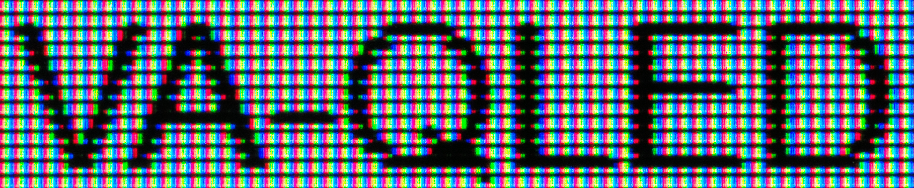

Text rendering doesn’t look too good on VA-QLED display panels.
VA-QLED displays make look good with high-resolutions (e.g. 4K).
However, the pixel density and quantum pixels used in the Samsung's VA-QLED displays creates an obvious “screen door effect” in the larger versions of the panels where you can see individual pixels even at a normal viewing distance. A shout out to the IGN review for noticing this problem.
You can see the outline of the pixels on a VA-QLED display, even at a normal viewing distance especially on areas of solid color.
This isn’t super-appealing but you won’t really notice it on the 60-cm model unless you stare at large areas of solid color all day. The real problem with this VA-QLED panel is that regular text looks truly awful. Modern web design trends tend to lean towards slightly grayer text, which the unusual quantum-sub-pixels produces by turning off half of the whole pixel. This leaves visible white lines striking through the text since every other row of quantum pixels are turned halfway off.

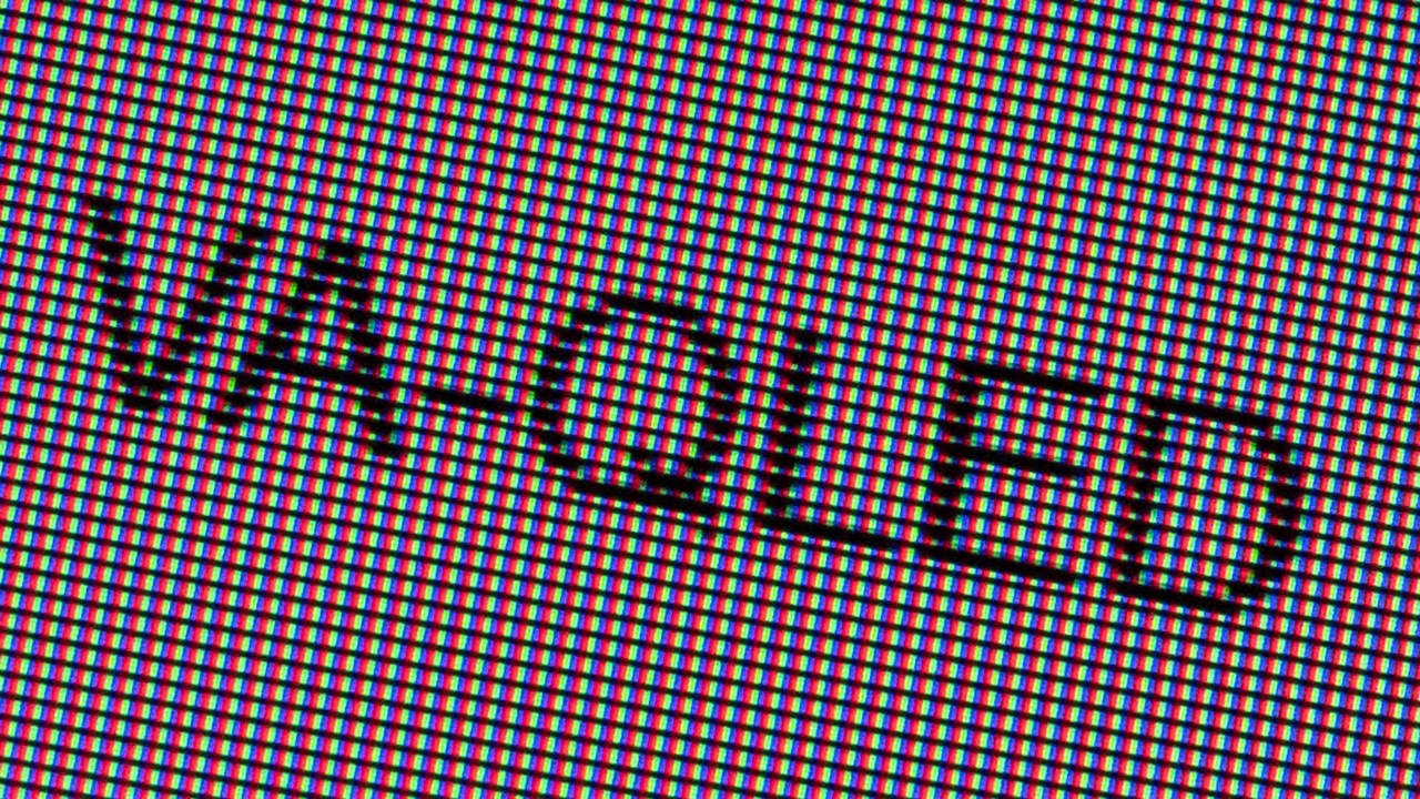

The following contrast-adjusted photo shows the text “VA-QLED” in gray photographed on the said panel. Click-through to the larger version to see it in greater detail. Note how the half-height sup-pixels negatively affect the gray text rending by introducing white dots scattered throughout the text.
Gray text

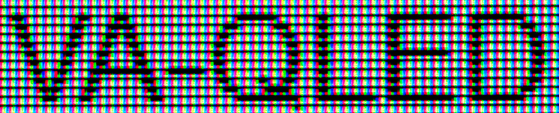

The next photo shows the same as the previous one, but with black text. Here, you can see how the half-height sub-pixels negatively affect the anti-aliased outer-edges of each letter glyph.
Black text
You can also see a larger version of the feature photo from the top of the article if you prefer a non-color-adjusted version where you can see even more details.

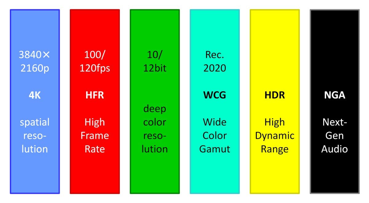

HFR - The one UHD technology you rarely hear about...https://www.flatpanelshd.com/news.php?subaction=showfull&id=1586323514
If you’ve been keeping up with Ultra HD TV technology, you may recall that there are essentially six pillars to it:
1.UHD or Ultra HD spatial resolution - 4K or 8K
2.HDR or High Dynamic Range
3.WCG or Wide Color Gamut
4.Deep color resolution
5.HFR or High-Frame Rate
6.NGA or Next-Generation Audio
source:[flatpanelshd.com]

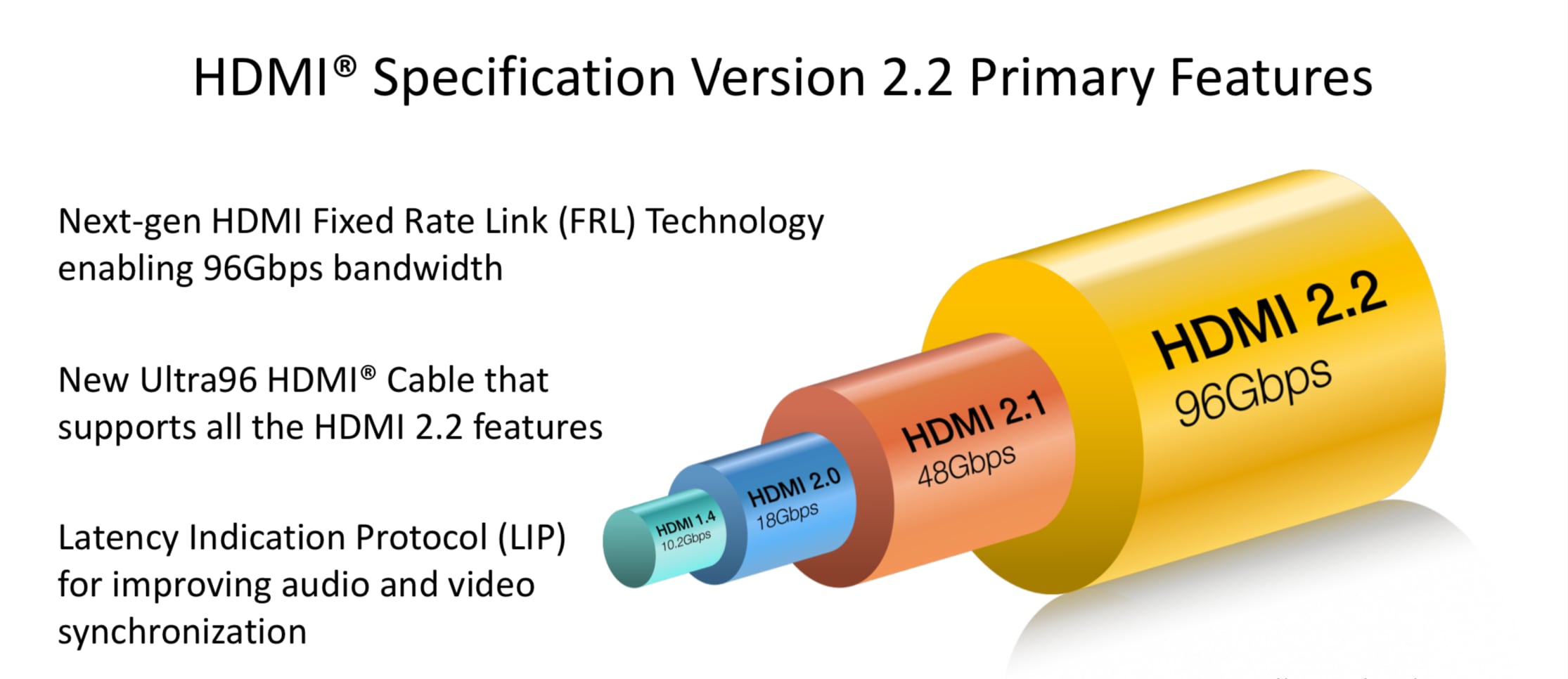

[flatpanelshd.com]...Next-gen HDMI 2.2 standard to be announced at CES 2025...https://www.flatpanelshd.com/news.php?subaction=showfull&id=1734208461
Το πρότυπο HDMI 2.2 επόμενης γενιάς θα ανακοινωθεί στην CES 2025

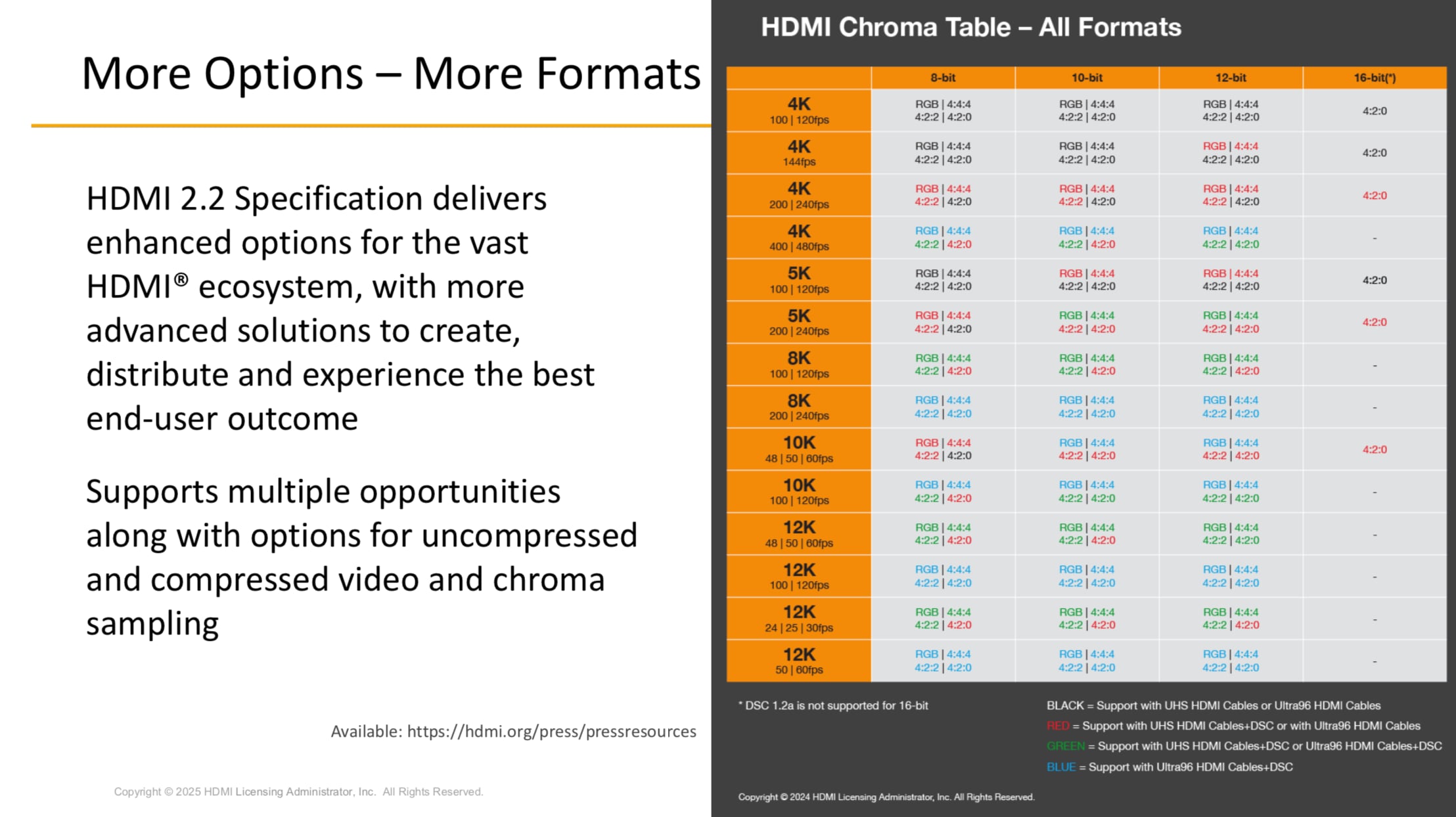

[flatpanelshd.com]...HDMI 2.2 announced with 96Gbps bandwidth for 4K480, 8K, 16K, more...https://www.flatpanelshd.com/news.php?subaction=showfull&id=1736186999
Ανακοινώθηκε το HDMI 2.2 με εύρος ζώνης 96 Gbps για 4K480, 8K, 16K και άλλα
