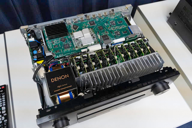

In addition, the audio board has been completely redesigned. The pattern has been greatly revised, and the left and right channels, plus and minus symmetry have been improved, and impedance has been reduced.
https://av.watch.impress.co.jp/docs/news/1263160.html
Το εσωτερικό του 4700H
Και του 6700Η με το monolith construction power amplifier, δηλαδή τις ξεχωριστές πλακέτες ανά κανάλι.
