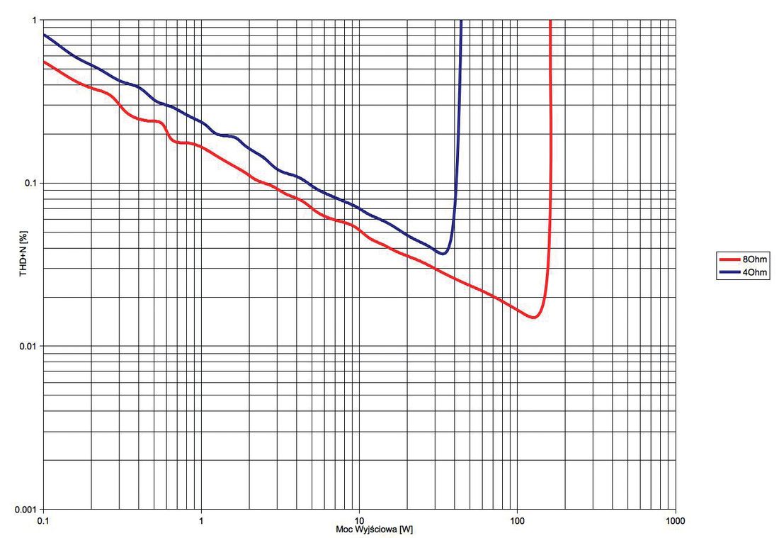

Ιn this case, the most complete and credible information seems to be in the instruction manual, according to which the output power is 105 W at 8 Ω, with a note that the distortion is even slightly lower - 0.08%.
But when driving one or even two channels at the same time, the AVC-X3800H can do much more (2 x 130 W), while with five less (5 x 84 W), and even more so with nine (9 x 49 W), which neither surprising nor disappointing. If we intend to connect 4-ohm loudspeakers, then, according to the recommendations, we should choose the appropriate operating mode for them.

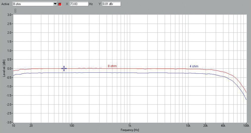

The frequency characteristics (Fig. 1) also show nothing disturbing, the linearity is excellent from 10 Hz, and the decrease in the treble range is small (at 100 kHz -1.3 dB for 8 Ω and -1.7 dB for 4 Ω) .

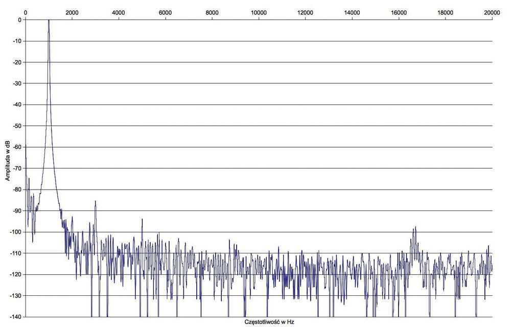

Also the spectrum of harmonics (Fig. 2) looks very good. The strongest third reaches -86 dB, the others lie below -90 dB.
