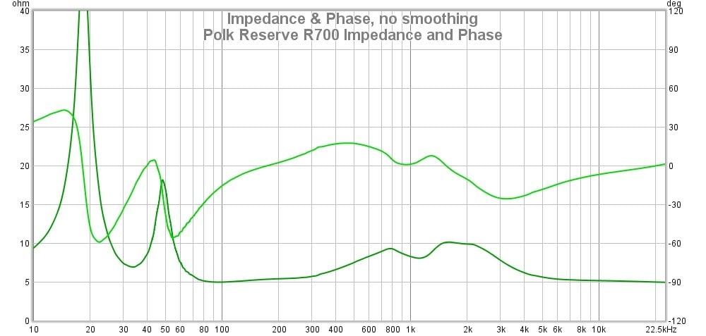

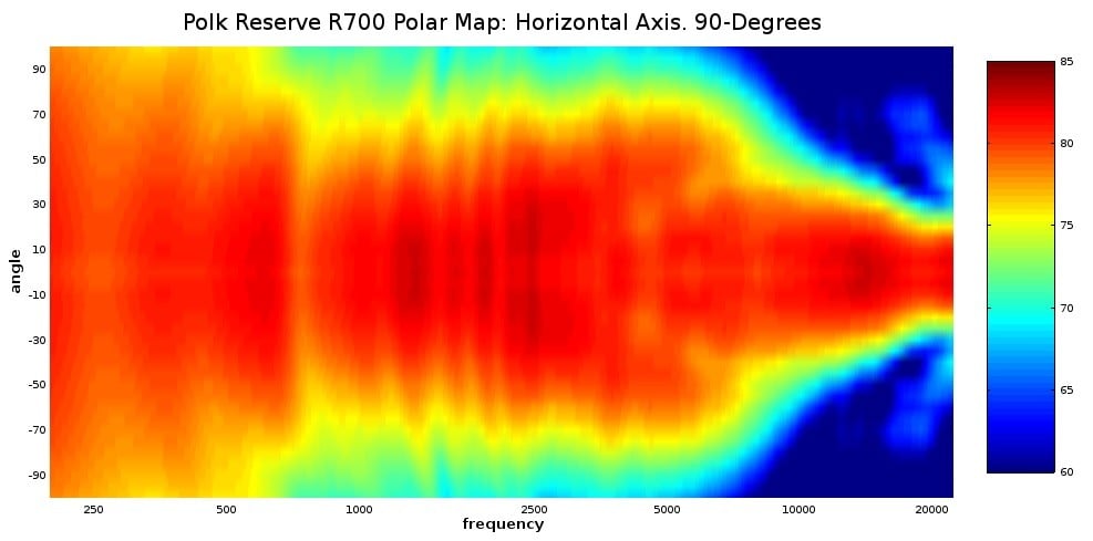

Polk Reserve R700 Floorstanding Loudspeaker Review​
