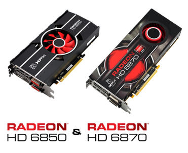

Κάνε υπομονή και σε λίγο καιρό βγαίνει αυτο....
XFX Radeon HD 6800
Key Features
– PCI-E 2.1
– Microsoft DirectX® 11 Support
– AMD Eyefinity Technology
– AMD Advanced Parallel Processing technology
– GDDR5 Memory
– AMD CrossFireX™ Support
– 3rd Generation TeraScale Engine
– 40 nm Process Technology
– Accelerated Video Transcoding
– AMD PowerPlay™ Technology
– Enhanced Unified Video Decoder (UVD 3)
– Enhanced Internet Brower Application Support
– Enhanced Microsoft Office 2010 Support
– HDMI 1.4a Support
– DisplayPort 1.2 Support
Στις φωτό είναι η 6850
