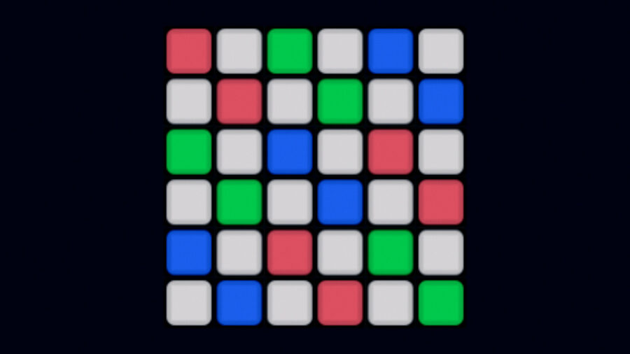

URSA CINE 12k LF Review - The BIGGEST thing since BAYER - Blackmagic's EXTRAORDINARY new RGBW Sensor​
Cinematic Super 35 12K Sensor​
The Blackmagic URSA Mini Pro 12K features a revolutionary new sensor with a native resolution of 12,288 x 6480, which is an incredible 80 megapixels per frame! The Super 35 sensor has a superb 14 stops of dynamic range and a native ISO of 800.
The new 12K sensor has equal amounts of red, green and blue pixels and is optimized for images at multiple resolutions. You can shoot 12K at 60 fps or use in-sensor scaling to allow 8K or 4K RAW at up to 120 fps without cropping or changing your field of view. URSA Mini Pro’s interchangeable lens mount lets you choose from the widest range of vintage and modern cinema lenses, so you can capture every ounce of character and detail from your favorite optics.
Eιναι η πρωτη προσπαθεια να φτιαχτει ενα νεο ειδος αισθητηρα μετα τα βατερλω των foveon της Sigma.
Απο μια τοσο μικρη εταιρεια γινεται μια προσπαθεια που μακαρι να δουμε και απο τους μεγαλυτερους
Reactions: evanfotis
Blackmagic’s RGBW CFA repeats on a 6×6 grid. It’s broken up into 9 macro cells. Each macro cell
contains two wideband photosites and two narrowband photosites.
Reactions: cacau and evanfotis

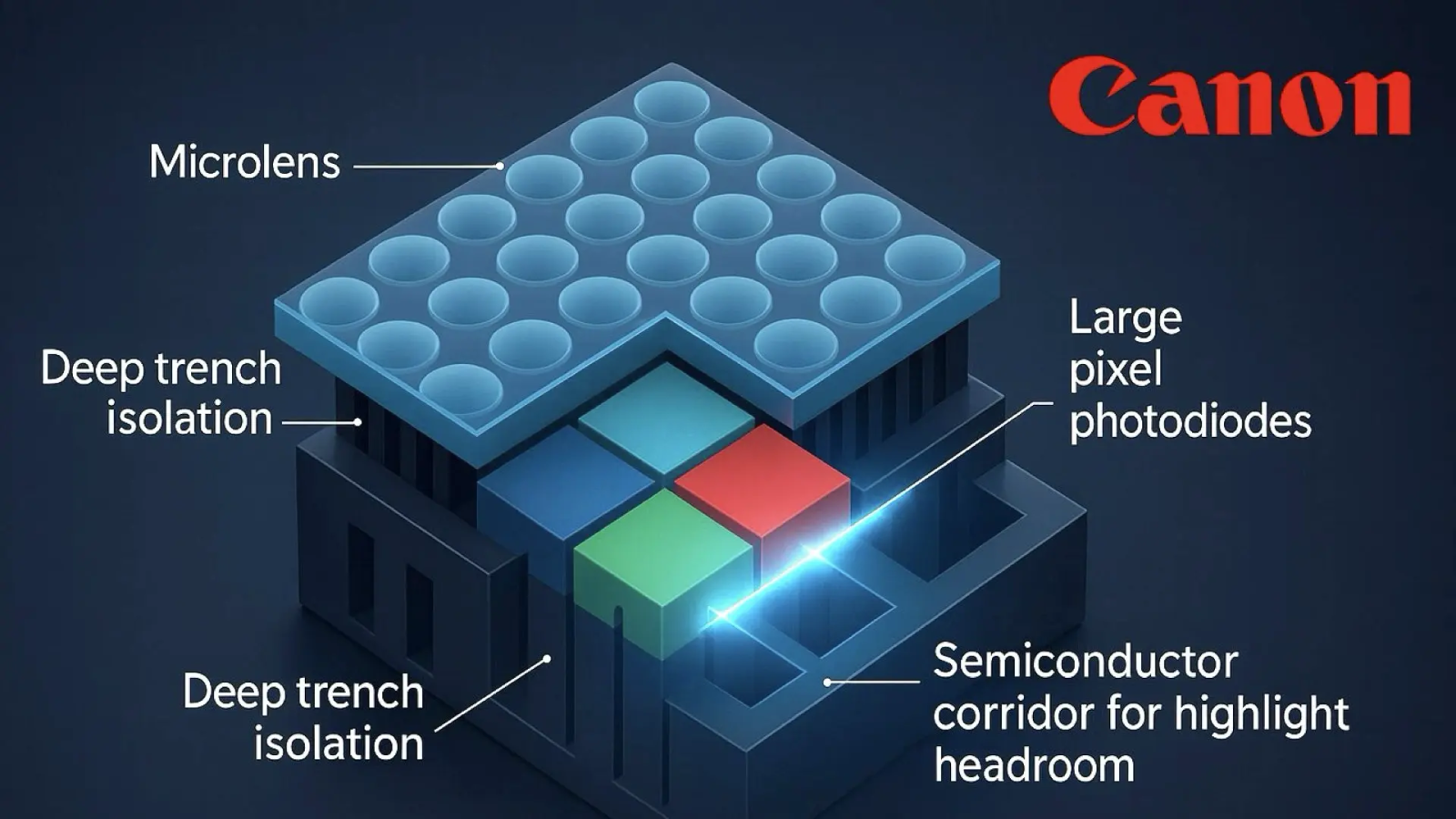

Why large format needs this (The cinema angle)​
Large format sensors collect rays that hit the corners at steep angles. That is where you see color shifts, vignetting, and weaker autofocus signals, especially with fast cinema glass. The first patent tackles those corner issues by aligning the microlens and the light sensitive areas with the real path of the rays. The second patent raises the effective full well capacity inside each pixel, which helps with bright skies, practicals, and specular hits that often push large format images into a harsh roll off.
Put simply
• Cleaner corners with fast lenses
• More consistent phase detect across the frame
• Smoother highlight handling without heavy processing tricks
Hence, these pixel level improvements map directly to Cinema EOS goals. Focus performance: Quad pixel phase information remains usable closer to the frame edges. That supports tracking in wide shots, gimbal work, and handheld coverage where subjects drift off center. Color and shading: Corner pixels behave more like center pixels. That reduces color casts that sometimes appear with strong off axis light and tight apertures. Grading gets easier and matching across lenses gets more predictable. Highlight roll off: In pixel charge sharing delays hard clipping. The shoulder of the curve becomes kinder, which is what cinematographers want when a bright window or a tube light enters the scene.
