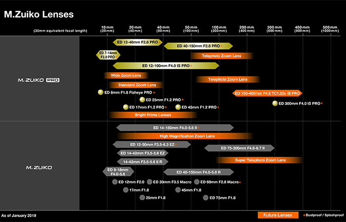

το νέο lens roadmap
Απάντηση: Re: Απάντηση: Φακοί για m4/3

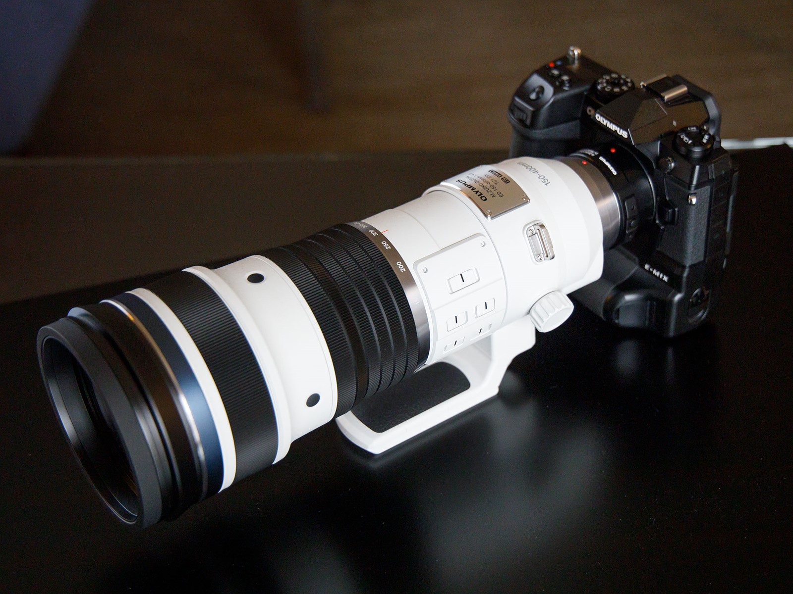

Ανακοινώθηκε η κατασκευή του νέου τηλεφακού και του διπλασιαστή :
The M.Zuiko Digital ED 150-400mm F4.5 TC1.25x IS PRO lens is designed for exceptional optical performance in a compact, lightweight form, and includes dustproof, splashproof, and freezeproof (14°F / -10°C) design with superb handheld usability. This is the first Olympus® interchangeable lens with a built-in 1.25x teleconverter, which easily extends the focal length to the maximum of 1000mm1 (35mm equivalent). It also offers in-lens image stabilization (IS), supporting 5-Axis Sync IS[2] when operating in concert with the image stabilization of Olympus OM-D® cameras. The compact system delivers remarkable portability, and the built-in teleconverter provides convenience, making it the optimal super telephoto zoom lens for sports and bird photography. This lens has an expected availability date of 2020. When using the built-in teleconverter widest aperture setting is F5.6.
The M.Zuiko Digital 2x Teleconverter MC-20 doubles the focal length of the master lens while offering outstanding portability as well as dustproof, splashproof, and freezeproof (14°F / -10°C) performance. The teleconverter is compatible with the M.Zuiko Digital ED 150-400mm F4.5 TC1.25x IS PRO lens, currently in development, as well as the M.Zuiko Digital ED 300mm F4.0 IS PRO and M.Zuiko Digital ED 40-150mm F2.8 PRO lenses. Not only does this teleconverter extend the telephoto range, but it also doubles the maximum shooting magnification of the master lens for unprecedented super telephoto macro shooting. This item has an expected availability date of summer 2019.

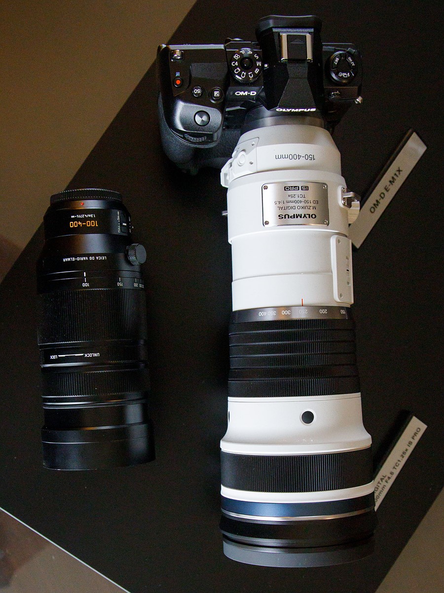

Γιατί τέτοια διαφορά μεγέθους με τον Πανασόνικ; τι παραπάνω προσφέρει ο Ολύμπους;
Τώρα είδα, νόμιζα ο Πάνυ οτι είχε σταθερο f/4 διάφραγμα αλλά στο τέλε φτάνει το 6,3 αρκετά σκοτεινός...

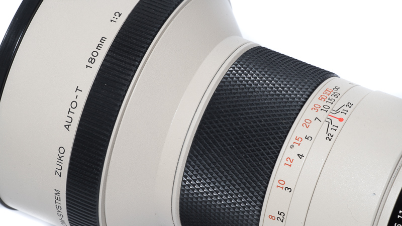

ο φακός με το λευκό του χρώμα θυμιζει την παλιά ΟΜ σειρά των φωτεινών μονοεστιακών
Nαι αλλα ασπρο ?
Ακομα και οι Canon φαινονταν χαλια με το ασπρο χρωμα μεχρι που υιοθετησαν ενα off white χρωμα τελικα .
Το γκριπ ομως της εστιασης ειναι απολυτως ιδιο εχεις δικιο
Nαι αλλα ασπρο ?
1. απαγωγή θερμότητας
2. οι canonians θα έρθουν πιο εύκολα στην oly αν είναι λευκό το τέρας.
Το βάρος ποιό είναι;
Απάντηση: Re: Φακοί για m4/3
Βλάση τιμή και βάρος δεν ανακοινώθηκαν. Γνώμη μου ότι θα είναι μέχρι 1.5κιλό.
