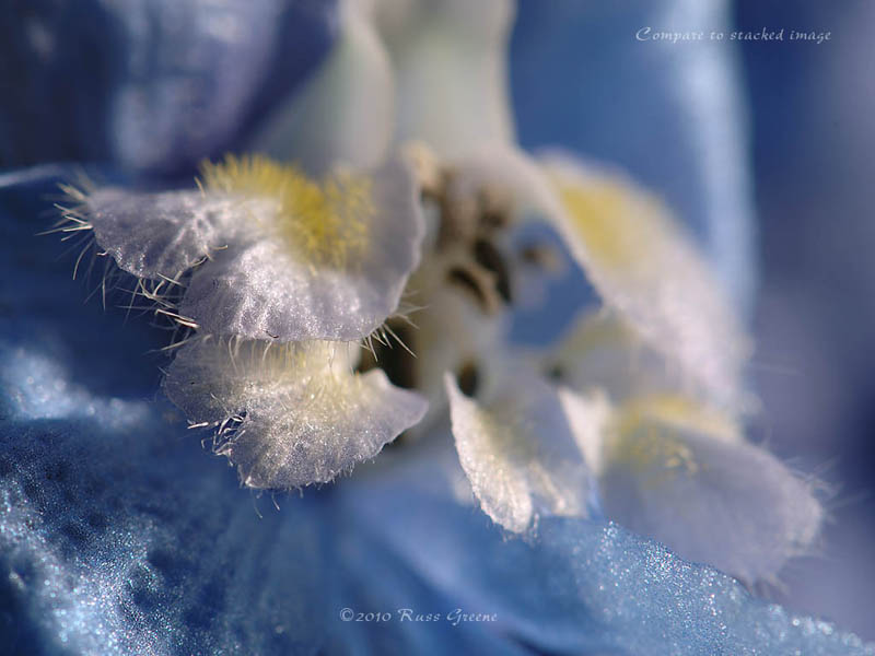

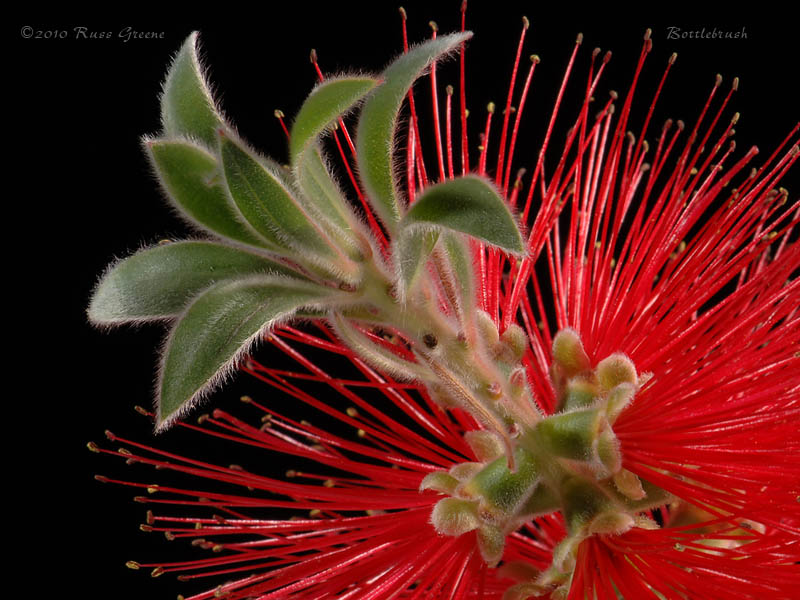

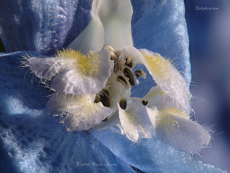

Immediately below is the finished photo. Below that is the the frame which is eighth in the stack.​
With Helicon Focus​
Without Helicon Focus (below)​
View animation and download stack
Additional Examples

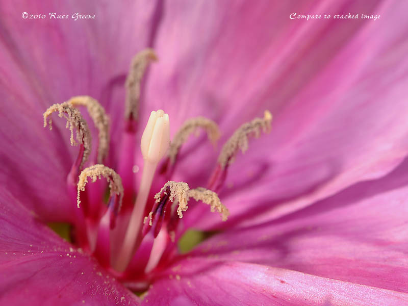

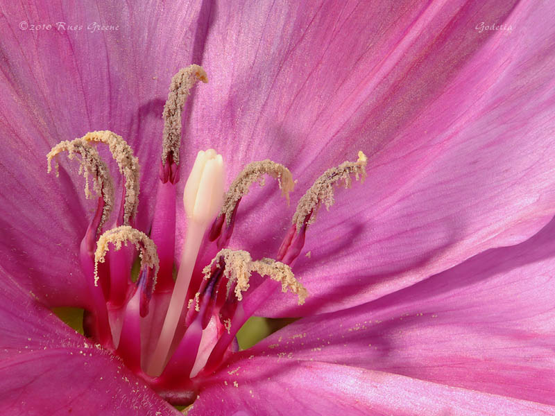

With Helicon Focus

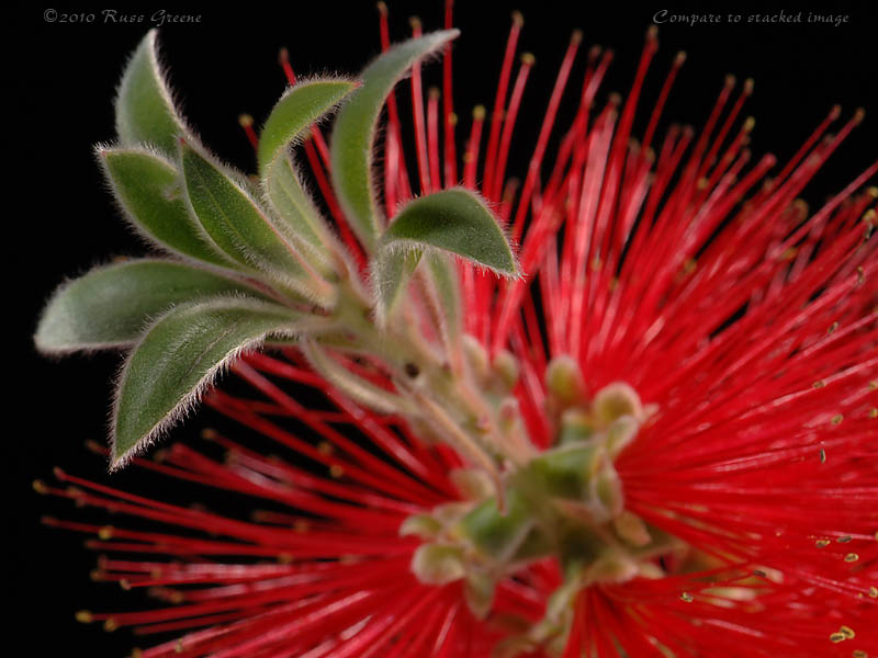

With Helicon Focus
