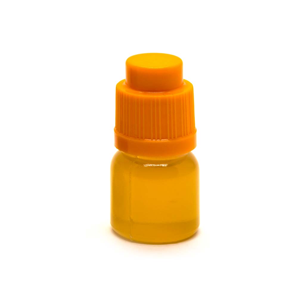

Αυτο λεει ο κατασκευαστης.
Bearing Oil
Bearing Oil​
We use a proprietary synthetic oil to lubricate the main bearing in all our turntables. The oil has to be a precise viscosity to enable our inverted bearings to circulate the oil correctly.
Bearing Oil
Bearing Oil​
Bearing Oil
Bearing Oil​

Εδώ μια σύντομη περιγραφή του λαδιού που προτείνω .
https://www.3345rpm.gr/product/van-den-hul-special-turntable-spindle-oil-λάδι-πικάπ/
